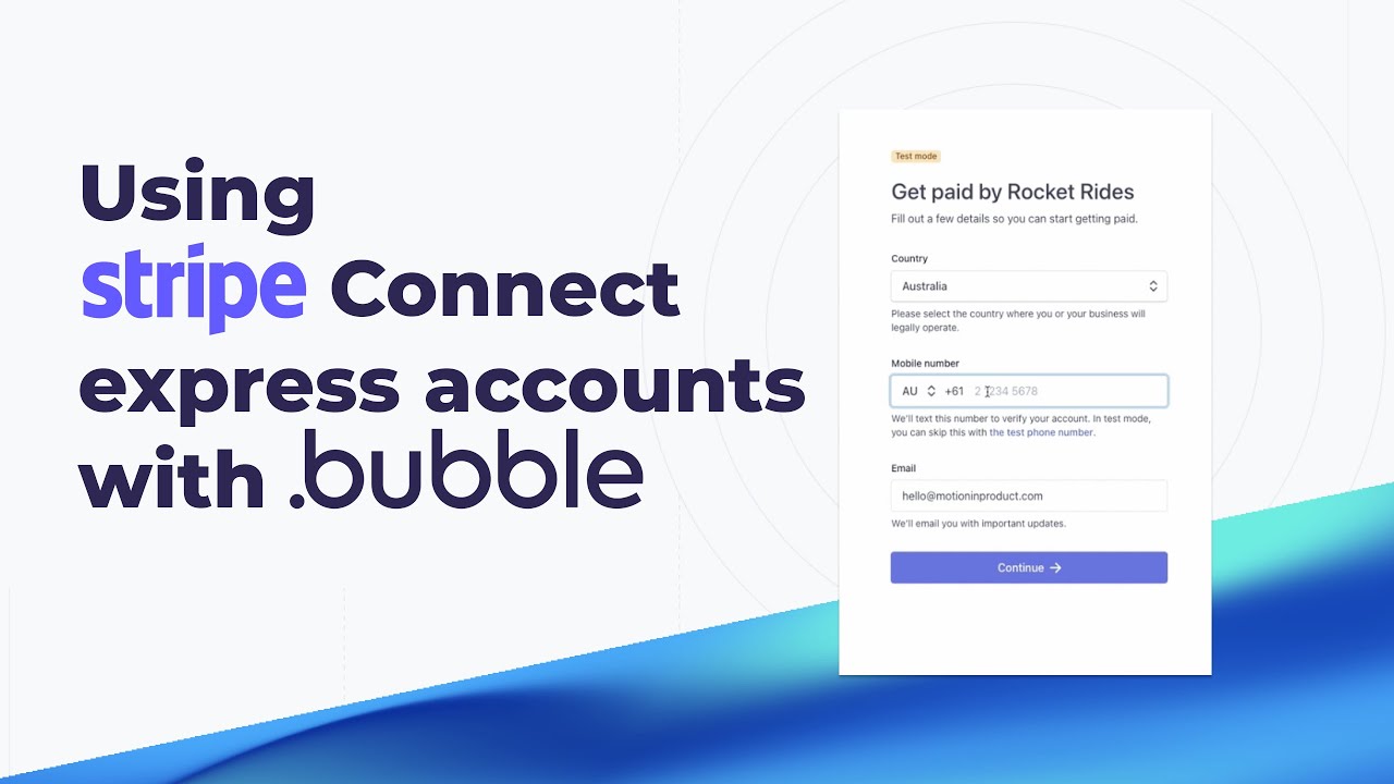

I created a video that walks you through setting up the API Connector to Stripe Connect for creating an Express account.
If you need more specific areas of the Stripe Connect API let me know as I figured out how to API Connector calls to do payouts and transfers too.
