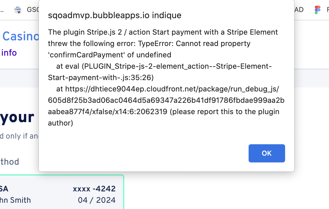

However, when I practically skip steps 2 & 3 and instead refer to a stored payment method id for this specific customer, it throws the following error:
Screenshot 2020-07-14 at 8.51.00
Would you be able to check in your workflow if this occurs when you refer to stored payment methods? (as I understand that you’ve built your workflow in the same way…)

1- ‘Start PaymentIntent - Create’, using the current user’s Customer ID
2- ‘Start payment with StripeElement X’, using Client Secret Result of step 1’s client secret, Generate payment is No, and using the payment method ID of the selected saved card. (which is saved as a custom state within the page)
But then, it stops working and I get the following message:
From what I’ve understood, it works ONLY when the user creates a PM using the StripeElement X, which generates a StripeElements PM ID. And I cannot figure out what I am doing wrong.
I haven’t understood what you said about the 2 different stripelements… and it seems I am in the exact same position as you were a few months back. Would be so kind as to giving me hand?
Looking forward to hearing from you !!
