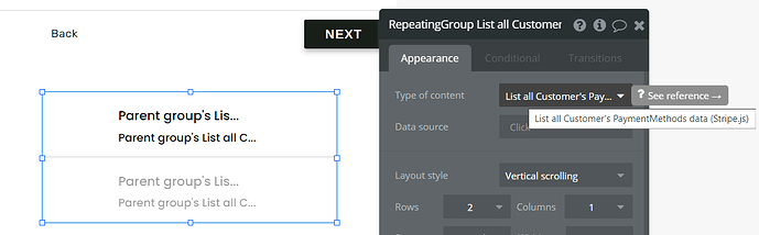

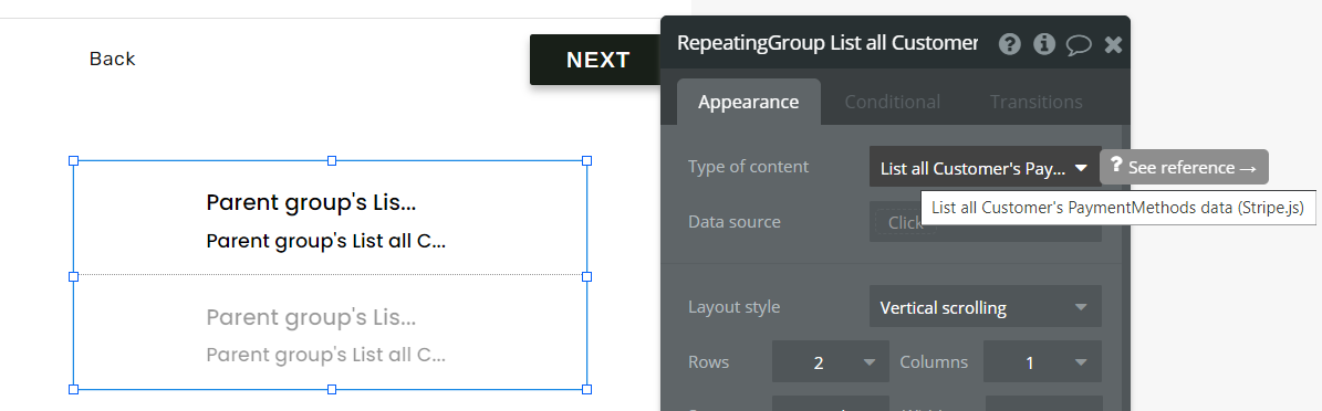

Display list of repeating group (e.g rgSavedCards) and then set the data source to >>> Stripe.js - List all Customer’s PaymentMethod’s data
I dynamically set the CustomerID to be the customer ID I have previously saved against the user.
My rgSavedCards then has a data type of Stripe.js - List all Customer’s PaymentMethod’s data and not Stripe.js - List all Customer’s PaymentMethod’s

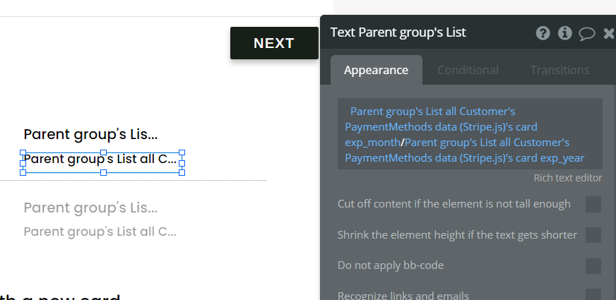

I then set the values I want to display using standard inheritance in my repeating group

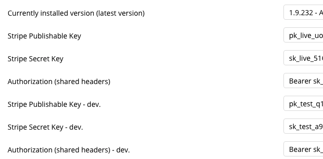

My problem was that my “Authorization (shared headers)” wasn’t correct.
When I used the debugger on the repeating group, I was getting an error saying I hadn’t provided authentication.
So I checked and I had the incorrect value in the Plugin auth field. You must add “Bearer” space “secret key” per the screenshot.
Now working fine.
