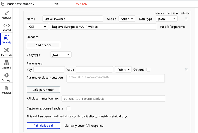

I have the CustomerID saved in my DB. I know that the API call “List All Invoices” can use the “CustomerID”. However, the plugin seems not to allow for this? Am I correct? Hence, why am struggling?

That’s the problem. I am not able to filter the data using the CustomerID.
For now, I have created my own call accessing the Invoice object directly. This did the trick leaving the “Parameter” dynamic.

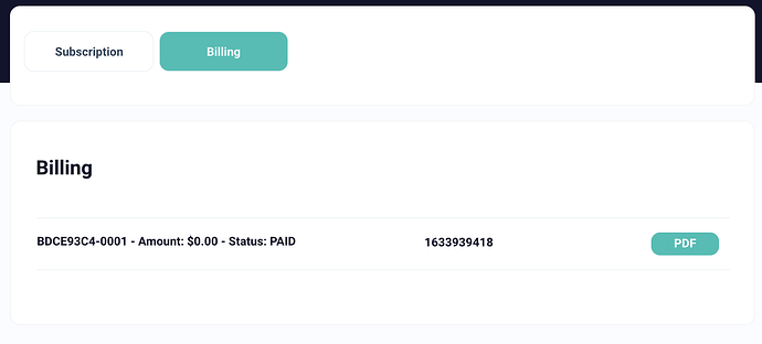

Hi Ben,
I have followed your instructions to pull the customer information related from my stripe account and it seem to work fine except the dates. (thank you so much for that :slight_smile: )

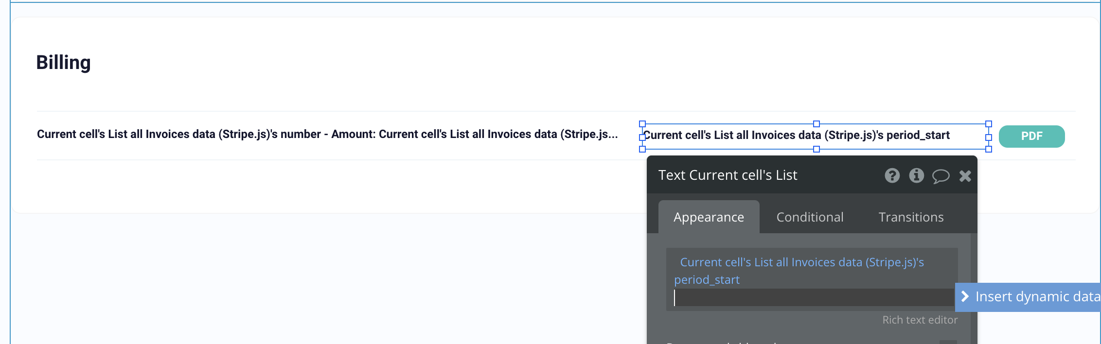

This first screenshot show the way it looks on my app. I can see the number, the amount and the status but the other number you see (163339418) supposed to be the “period start date” (You can see on the secon screen shot
And the same result happen for any type of date that I try to pull from stripe. Do you have any idea why this is happening?
Have you tried adding the “…formatted” as option for dates?
