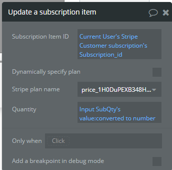

I am trying to update the quantity for a subscription. I have an update subscription step in my workflow:
But the “Subscription Item ID” isn’t returned within Bubble, and it isn’t the same as the “subscription_id”. This is the field I think it is looking for in Stripe:
But I can’t work out how to pass this within the workflow.
Any help would be much appreciated! :slight_smile:
I just wanted to update this post in case somebody tries to Google this solution (as I did) - I worked it out!
The trick is to use “Subscribe the user to a plan” as per the below:
