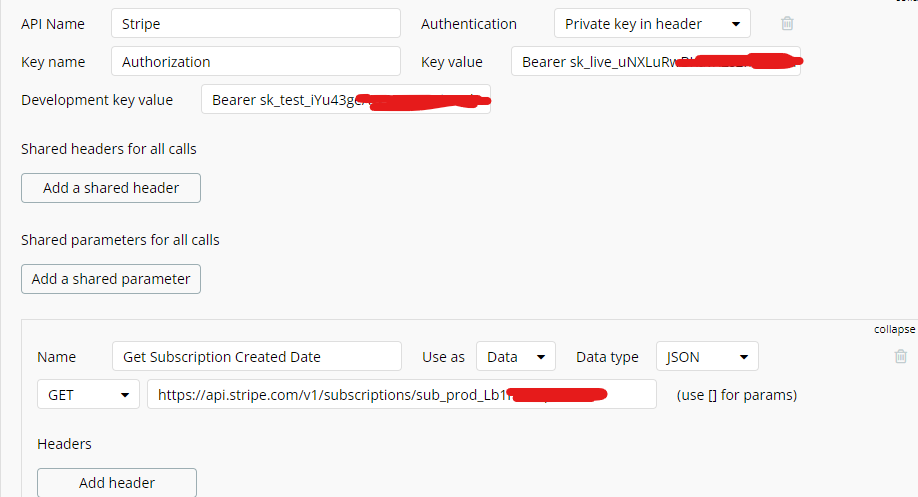

Perfect. I have now made my ‘GET’ URL
https://api.stripe.com/v1/subscriptions/sub_`[my Stripe-Account ID]`
You don’t put your account ID there… you need to put the ID of the subscription you want to retrieve.
As for the rest… there’s a lot wrong here…
Firstly, I’m not sure you want to be including the private key the URL (it might work that way I’m not sure) - but I use Private key in Header as the Authentication type for Stripe.
In any case, you need to include the ‘live’ API key (your live Stripe Secret Key, NOT public key), preceded by the word Bearer, then a space, where it says ‘Key Value’, and your Development key (i.e. your test secret key) where it says Development Key Value. e.g. Bearer sk_live_******************** & Bearer sk_test_********************
The Key name needs to be Authorization
You don’t need any headers in you actual Get Subscription call, just set up the URL with a dynamic value for the Subscription ID (use to make it dynamic)
Also, it’s probably not a good idea to post your Stripe API keys here in the forum (certainly not your secret keys - even test ones), nor your Stripe account ID, for security reasons - so I’d delete those from your post if I were you.

Thank you, I have now made my ‘GET’ URL https://api.stripe.com/v1/subscriptions/sub_prod_Lb1hTL2xxxxxxx. I used the product ID, not the price ID.
I’ve done the same and added my Live and Development keys using the instructions you provided and the Key name is Authorization.

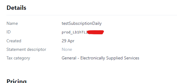

See the screenshot below of my subscription, it only offers a product ID.
The image you’ve attached is for a Product (not a Subscription).

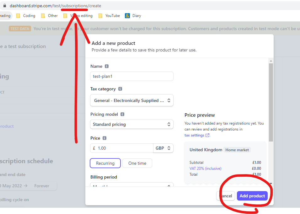

I have followed the instructions on how to create a subscription. On the Billing page I click “Create subscription” and I am once again taken to the ‘Add a new product’ page. Notice the URL says I am in ‘subscriptions’ but the content is for Products.
That IS the create Subscription Page - but it looks as though you’ve clicked on Add New Product? (that’s the only way I can replicate that behaviour)…
Did you click Add New Product? (if not, then it could be a bug with Stripe, although I’ve never experienced anything like that before…)
In any case you should just be able to close the Add New Product Window.

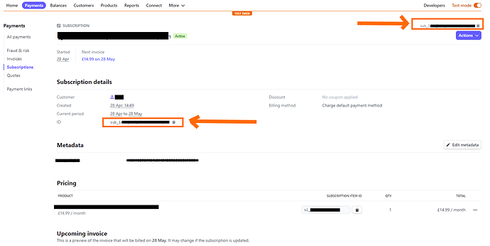

As much as I have looked, I don’t see a Subscription ID anywhere for my previous or new subscriptions?
When you click on a Subscription to open it the Subscription ID will be shown in the top right of the screen, or in the main Subscription Details Panel:
Thanks @adamhholmes , I see the Subscription ID now and I know why I was confused.

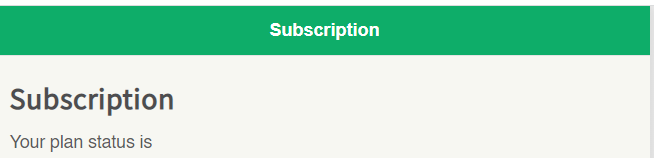

There is just no communication with Stripe. It seems whatever I try I can’t ever get Stripe to ‘talk’ to my app.
For example, the following settings should return data;
But I see this when previewing my site;

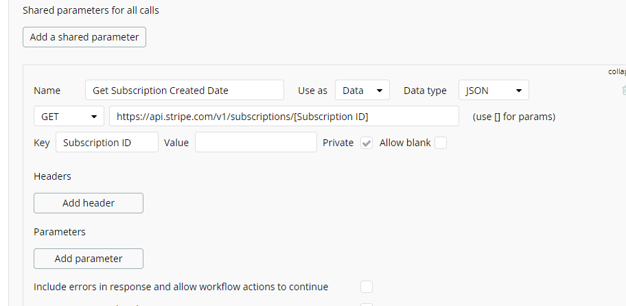

In your screenshot in your previous post you’re using a static Subscription ID. Obviously in your app you’ll need to make that dynamic by adding square brackets in the URL.
I have just done this and now it’s asking for a Value?
UPDATE: Having just had a quick look at your app again, you’ve got an empty parameter set up in your API call - so as it is the call will fail - so you need to get rid of that (I’m not sure if that’s what the issue was before, but in any case you need to delete it)
Done.

Yes, in the value you need to enter the dynamic parameter value you want to put within the square brackets…
So you don’t put the whole URL in brackets - just the part you need to define dynamically, i.e.https://api.stripe.com/v1/subscriptions/[subscription_ID]
Then you enter a value for the ‘subscription_id’ - to initialize the API call you’ll need to enter a static, valid Subscription ID - but obviously when using the call in your actual app you’ll make that dynamic - i.e. Current User’s Subscription’s Subscription ID (or wherever it is you’re saving the subscription ID in your database)
note: you need to uncheck the Private box in order to be able to set the value dynamically in data calls in your app.

Thank you. This is a perfect example of why things are so hard for me, even this one step can be impossible to achieve.
I’ll explain why because I’m guessing many Bubbler’s know this feeling…
The layout on the API Connector is;
GET https://api.stripe.com/v1/subscriptions/sub_ywth****
Key:
Value:
As you’ve said I don’t put the whole URL in brackets - just the part you need to define dynamically. The trouble is, this could be any of the following;
Key: https://api.stripe.com/v1/subscriptions
Value: sub_ywth****
Value: sub_ywth****
GET [https://api.stripe.com/v1/subscriptions]
Value: [sub_ywth****]
GET [https://api.stripe.com/v1/subscriptions/sub_ywth****]
These are all slightly different and I can think of more variations. I could test all of them, but when they all fail I will never know if the variation was wrong or if something else in the set up is wrong.
This is the same for many steps in the process, I never know why something failed because there are so many variables, the overall picture is too complex.
This is why I think I need painstakingly simple instructions, explained as you would to a 10 year old beginner, with images and explanations of what the steps are required for ie. why something is done. This is obviously too much to ask of you or anyone else without paying for your time.
If that’s literally all you’re trying to do then I don’t see any reason to be using any webhooks - you can just use an API call to get a user’s subscription status as and when you need it.
I had thought that I need to also show a message if the users card fails. In any case, going right back to the original problem, if a user unsubscribes I need to say “your subscription has ended and the last payment will be on xx/xx/xxxx” and this is why we started to set up the API.
I guess what I mean is that my requirements would be considered the most standard for a subscription service ie, subscribe, unsubscribe, get notified of status and if card has failed. I’m amazed that there isn’t a wealth of info online for this. I’ve done 20 tutorials but nothing comes close to explaining to a beginner all the steps needed.
I really don’t understand what you’re saying here at all?..
The URL remains the same - the only thing that changes is the Subscription ID
There are no variations - just the Stripe Endpoint URL (it’s always the same) - you just need to use change the subscription ID dynamically.
So as I said before: https://api.stripe.com/v1/subscriptions/[sub_ID]is the URL you need to use.

They key is just the name/identifier of the parameter (it can literally be anything you want to call it). And the value is the value of that parameter (i.e. the Subscription ID).
So, again, the URL can be https://api.stripe.com/v1/subscriptions/[sub_ID]
In this case the Key is sub_ID - but you can call it anything you like (subscription_ID, parameter1, URL Path, Mr Smith - literally anything, it makes no difference) , although obviously something descriptive, that you’ll recognise when you need to define it on your pages, is the most sensible thing to do.
And the value is, in this case, a Subscription ID. On your pages that will obviously be a dynamic value (i.e. the ID of the particular subscription you’re trying to retrieve), but in the API connector, in order to initialize the call, it has to be a specific valid Subscription ID.
