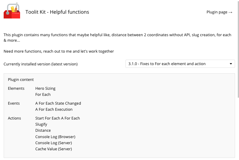

@AliFarahat has a plugin for this
Yes its there! Thanks. If its not working as expected message me

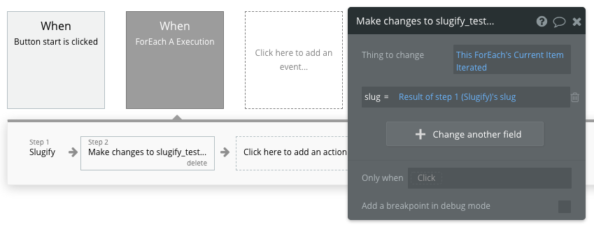

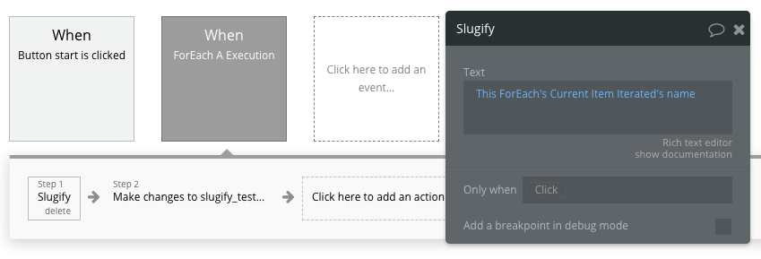

I have played around with the plugin with a test page and test data ( just 3 simple entries )…seems to work fine in that the data gets saved as a slug ( excellent! )
However I get this error messages during the process
53%20PM 05%20PM 13%20PM
What is strange is that despite the error messages the process still works and my slugs are saved to the database
What makes this stranger is that the slugs get saved before the workflow seems to be completed as the blue progress bar never actually goes complete and therefore just remains on the screen requiring the page to be reloaded to get it off
40%20PM
I set the workflow up to run off a button press
What I noticed is that if I disable the workflow “When ForEach A Execution” I get only one error message and only the first item in the database has the slug saved, and after pressing ok on the error message the blue progress bar actually finishes and the page doesn’t need to be refreshed.
Another odd thing is that when I have the workflows enabled and all three error messages are displayed ( one for each data entry I assume ) is that when I am in the database and delete the slug entries they get repopulated if I leave the app page open while the progress bar remains incomplete and visible.

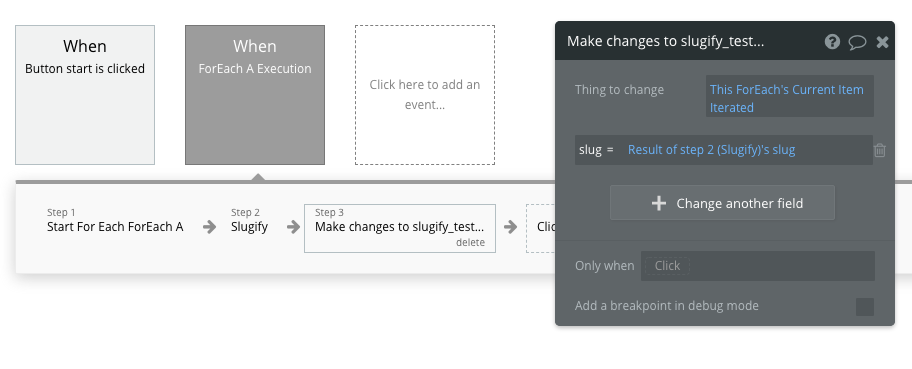

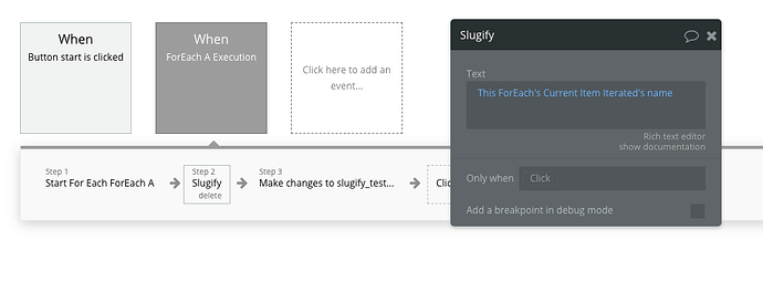

Ok, I edited my workflow to what I think is the correct way to actually utilize the plugin.
Now when I click the button to start the workflow I get no error messages and all three entries have a slug saved correctly and the blue status bar completes ( quickly as well ).
And now I realize that when I was working on adding slugs to a large list of items ( mine was 1715 items ) that it might cause the error due to processing / downloading such large amounts of data as I saw in the inspector.
So to still utilize the plugin I made it work for list items from and until to get a manageable number of items
Hope this helps somebody else looking into using the plugin for creating slugs
Yep thanks :+1:. Thats the right way of doing it. You can also adjust delay of the execution to make sure the slug is available. But bubble already does that as your using results of step 1. Hence that’s why there are no extra promises in this plug-in

It looks like that plugin is no longer available. Any others that slugify? I’ve searched and not found anything.
I use this plugin heavily. It’s still available. It was renamed to ‘Ultimate Toolkit’ I believe.
I saw that, (Ultimate Toolkit Plugin | Bubble) but the creator is The Upstarters Contributor Profile | Bubble instead of @AliFarahat so I thought it was a different plugin.
Also, I could not get the slugify feature to work using that plugin. Even searched the plugin codebase and found no reference to slugs at all.
I believe he’s a co founder of the upstarters.
As for the slug feature, I’d probably reach out to them for help. I don’t use that specific feature, primarily the ForEach functions etc.

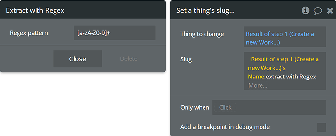

  • This Regex pattern extracts any text or number from the string
  • The square brackets stands for a character set to match
  • The + stands for 1 or many occurrences
  • You don’t have to worry about lowercase, dashes (-) or duplicates. This will be handled by Bubble itself, since the Slug has to match certain criterias.
Test the regex in a regex tester to see how it works:
This works well! Thank you @CosmicSelf
The Ultimate Toolkit
I used this recently and it works perfectly for creating slugs using Slugify as the action and any text value as the input.
