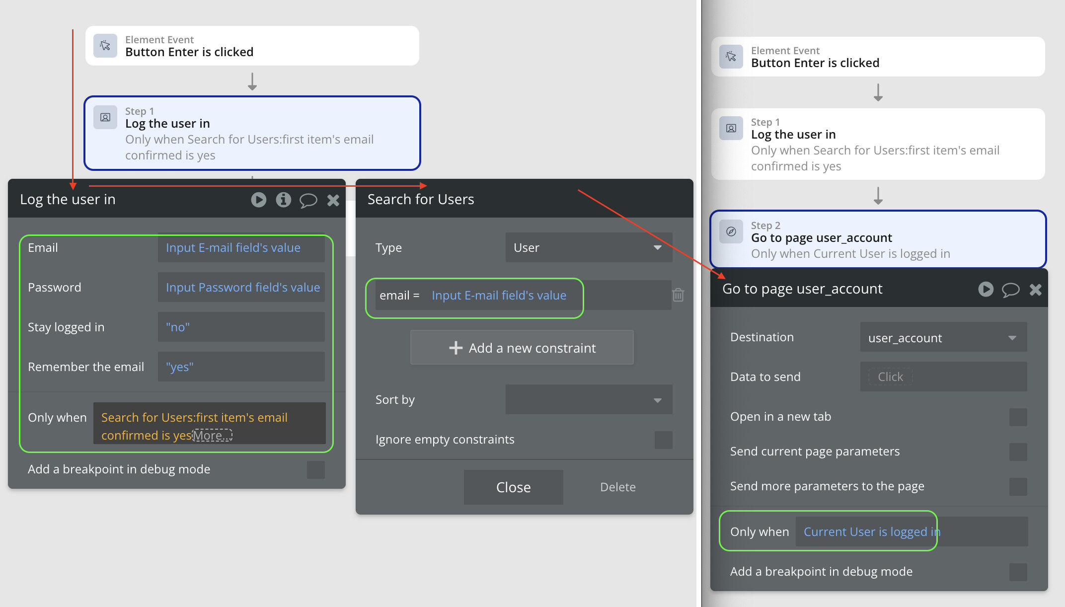

My settings attached

For now the only page action is described here (linked with “Enter” button):
Maybe the Log in action is not executing because the conditional evaluates to false?
Is the Go to page action executing nevertheless?
Exactly. But why I don’t have any pop-up error about this ?
Isn’t it integrated in bubble core ? I mean INVALID_LOGIN_CREDENTIALS Core message
Nope. Nothing happens after entering non-existing credentials and hitting the button “Enter”
:man_facepalming:
Because it’s not an error, it’s just what you have told the code to do. Bubble it’s just skipping the Log the user in action because there’s a conditional instructing to do so.
The simplest solution is to divert the execution in two flows
  1. one for registered users, that will check if they have confirmed their email and log them in, and otherwise will terminate the flow and show a custom error message
  2. another for unregistered users for the Log the user in action to fail with the default error
Other more optimized options might be suitable, but I haven’t invested time to think about them
