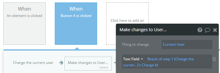

Based on your other post, I am guessing this is because your Data’s Charge id field is set to a type other than text?
Saving the Charge Id should look like the following.

Awesome, worked perfectly! Thanks
