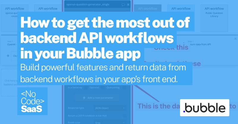

Perhaps consider this approach by @jamesdevonport
