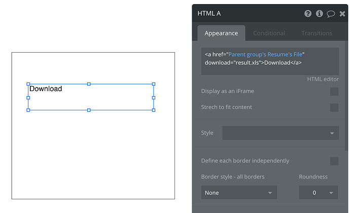

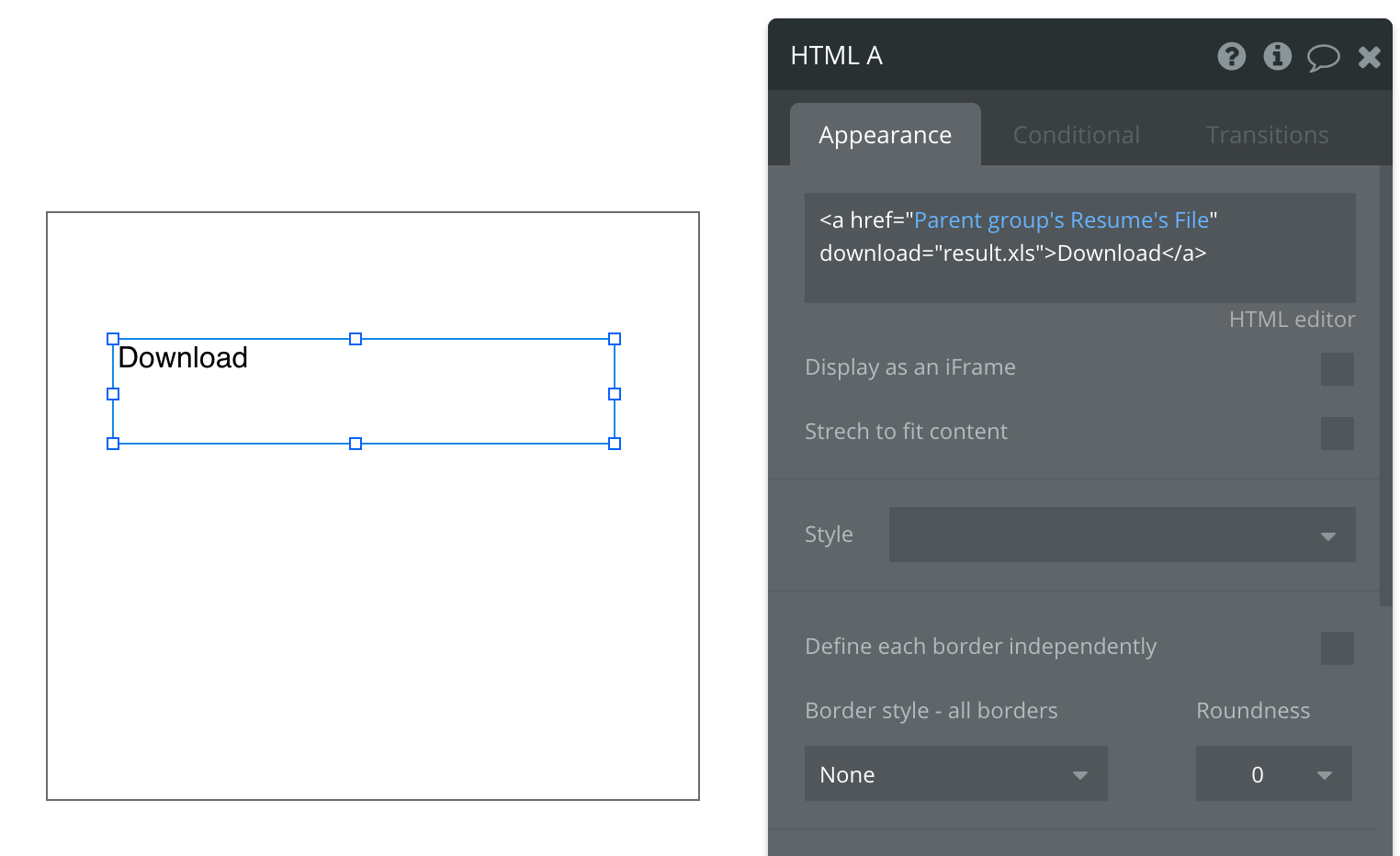

I found this option on Stack Overflow and tested with jpeg and txt; I think it works! :slight_smile: With an HTML element use the code:
Thank you very much, Faye, you almost solved my issue! There is one problem and that is that when I tried to download one of the pdf files it downloaded result.xls instead! Strange huh?
My pleasure Andreas! :slight_smile: I just tested with a pdf as well and it did download correctly for me. However, when the file field is empty, it will download ‘result.xls’ instead. Maybe double-check to see if the file field that should contain the pdf isn’t empty?
Yes it contains a file, and this only happens to one pdf file over and over again.
Does this one work for you? (removing the results.xls)
I also noticed in the first example that I just put “Parent group’s Resume’s File”. Even though this worked, I should have put “Parent group Resume’s File’s URL”.
Now i think it really works, but im still going to test with some more files. So thanks again ! :raised_hands: :tada:
