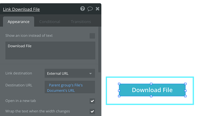

How do I download files
that have been uploaded by other users in the app. The file type would typically be excel and pdf type
thanks in advance
You can do this using a link element, with the dynamic data being in this format (here File is the data type, and Document is the field where the file is stored):
Here, after you select the field where the file is stored, click ā€œmoreā€ and you’ll have the option to select ā€œ's URLā€.
Then you can style the link to look like a button, and that should do it. :slight_smile:
thx, and what if there are multiple files (since stored as list of files)?
You would use a repeating group (with the data source being that list), and within each cell is the link element. The dynamic data would be: ā€œCurrent cell’s File’s Document’s URLā€, and the User would be able to save each file individually.
The link element’s text could include the name of the file as well (instead of just ā€œDownload Fileā€), to show the User what they will be downloading. The dynamic data for the file name would be ā€œCurrent cell’s File’s Document’s file nameā€, instead of ā€œ's URLā€.

Hi, some browsers are blocking the file tab from opening when you click the button. Is there another way to download the file?
Did you have any update on blocked download ? thx
It seems working only with PDF files. I have tried it with .xls and .doc and it was blocked.
2 years late, but for anyone else who stumbles on this thread and runs into the ā€œblockedā€ issue:
Use the ā€œOpen an external websiteā€ action, and manually add https:// in front of the file’s URL.
So instead of just using:
This File's URL
Use:
https://This File's URL
That fixes the issue and lets the file open properly in the browser.
