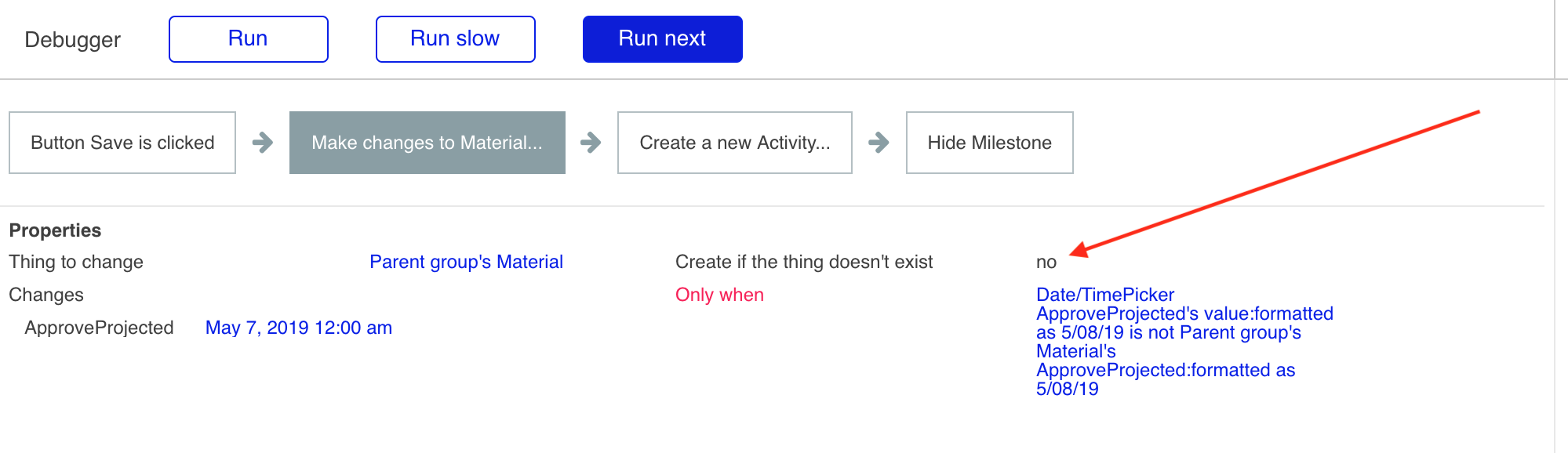

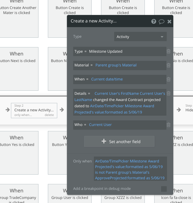

I’m having some trouble getting my “Only when” statements to work on conditional workflows. In this scenario I want this part of the workflow to run only if the Input (a date in this case) and the corresponding Thing’s field are different.
Here’s what I got:
When the “Only when…” statement is present and the condition is “true” the workflow DOESN’T run. If I remove the statement it runs fine. I’ve also tried creating the statement a couple different ways without any luck.
Anybody have any ideas? Thanks!

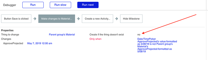

If you haven’t done so already, I would suggest using the built-in bubble debugger to confirm that the two values you’re comparing in your condition are what you think they are.

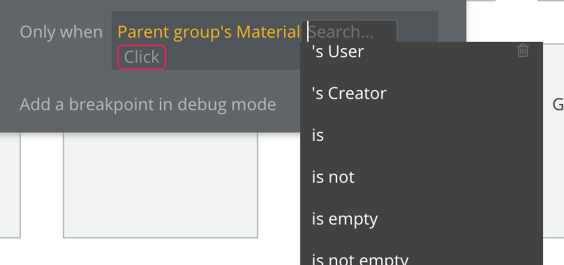

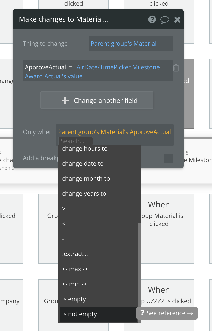

@cdorozco16, I tried that and there isn’t an option for “is not”. Here is what I see…
The field type is a date. I tried it the other way around as well (field > thing). Any other ideas?

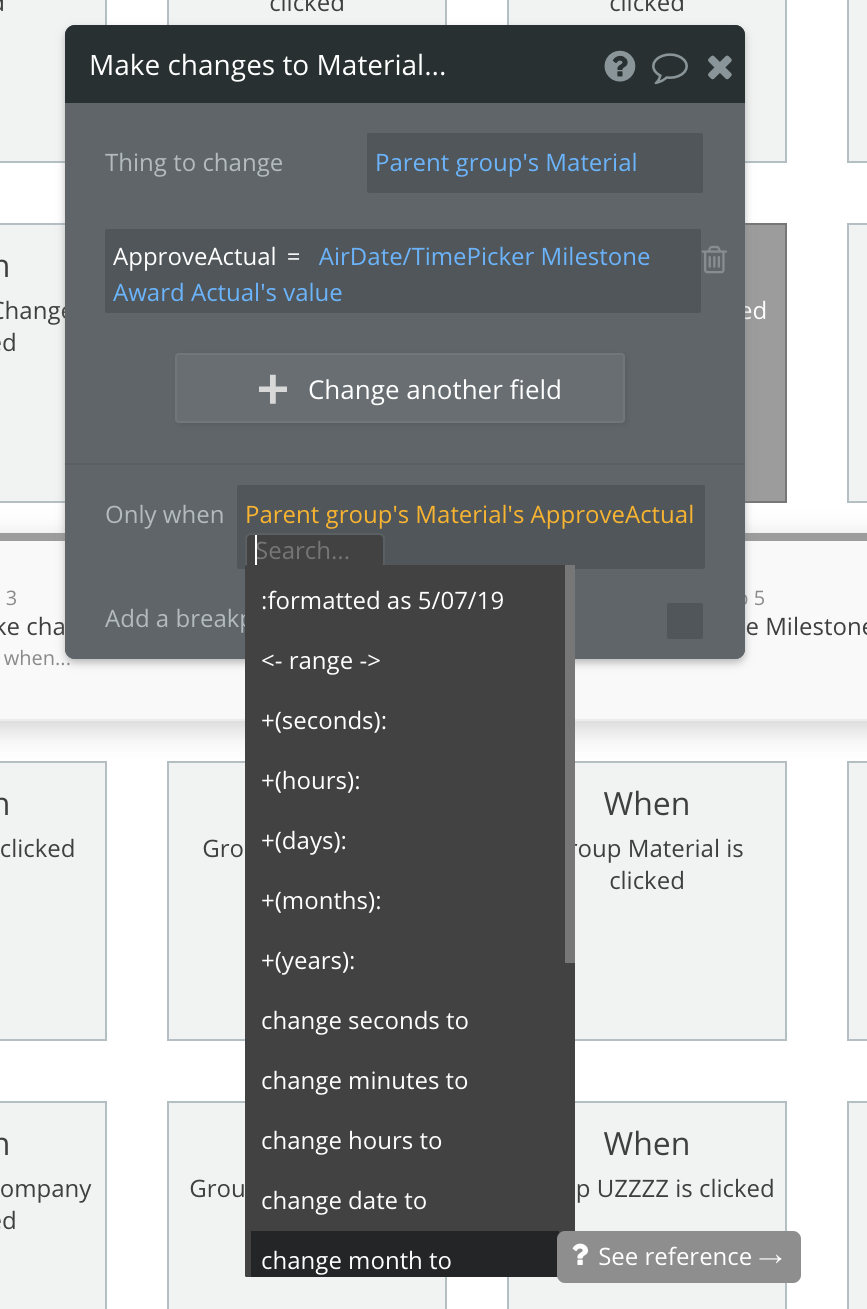

Initially you had
AirDate/TimePicker Milestone Award Projected’s value: formatted blah blah
Keep it exactly like you had it before. Just remove the formatted blah blah part.
After removing the :fortmatted blah blah part, verify that both items have the value you expect. Create a temporary text box that you can see that shows the value for Milestone Award and for Martial Approved just to make sure the numbers look right.
Hmmm…It’s not an option unless I have the :formatted blah blah in there.

I tried your greater than idea and it worked just fine. I can only get the “is not” option to show if I just pick “parent’s group Material” and not drill down to the field I want to check.

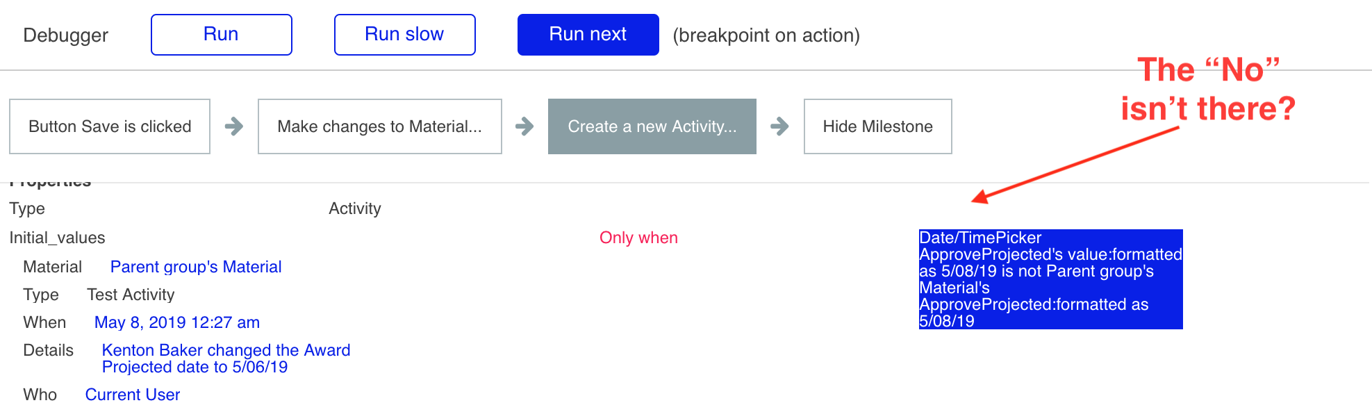

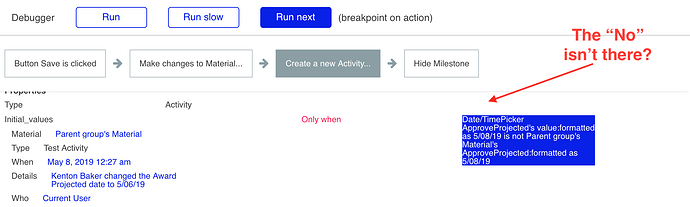

@cdorozco16, Ok this is weird. I have two actions associated to this workflow: 1) Update the Material’s field, and 2) Create a new Activity. Both have the “Only when” condition associated to them. What’s weird is that the 1st action runs just fine, but the second action doesn’t run with the “Only when” condition. If I remove the condition then the Activity gets created. There’s something about the condition it doesn’t like which is preventing the Activity to be created.
I ran the debugger (which I’m not super familiar with) and it looks a little different between the two actions:
  1. Make changes to a thing if field value is not Thing value.
  2. Create a new Thing (Activity) if field value is not Thing value.
Again, the 1st action appears to run fine and the 2nd doesn’t run (i.e. an Activity isn’t created).

What makes me wonder is, you are changing one of the condition parameters (Parent group’s Material’s ApproveProjected) in the first step. Are you changing it to a value which should actually result in a “yes” in the second step? From what I see, this may be not the case (as you set it to AirDate/TimePicker Milestone Award’s value ?).
The difference in the propierties you marked in your latest screenshot is there because you are using two different actions. If the second action would be a “make changes to…”, there would also be a “Create if the thing doesn’t exist”.
So, I simply reversed the order of the actions and it worked! I’ve done several tests with different dates (and also using the same date) and it works like a charm.
