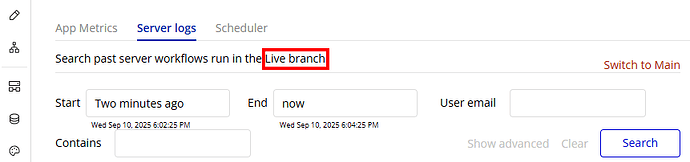

I’m troubleshooting a problem on the live version of my site. The problem doesn’t present in dev. For some reason, nothing is showing in the Server Logs on the Live branch. I tried added &debug_mode=true to the URL in production, but it just redirects to remove that bit.
  1. Why aren’t server logs being recorded in live?
  2. How can I turn on debug_mode to track down what’s going on?

In your Logs, have you checked that you are viewing the “Server Logs” and seeing “Live branch” to indicate you are checking the logs for the Live branch? If so, are there any filters which may be preventing your logs from showing (like the start, end, User email, Contains…? Have you clicked the “Search” Button after checking your filters? The logs do not load immediately.
Finally, the logs will not show every page interaction. They are not the same as Debug Mode. The interaction must impact the server somehow (showing popups, searches on the page, etc. will not show up in the logs). If you edit a database record, run a backend workflow, etc. this would show up.
