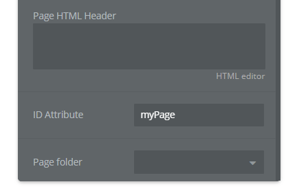

  1. Add an ID to your page

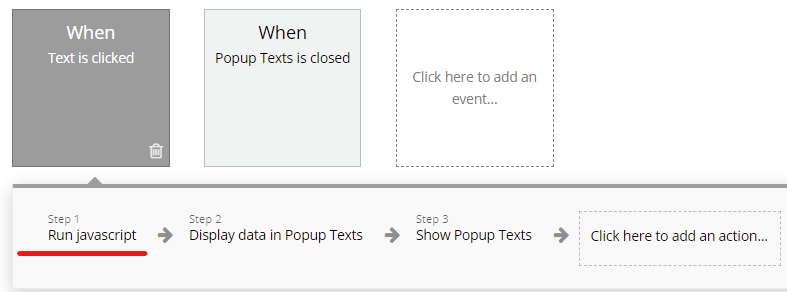

  2. When the popup is opened: Inject some JS when the popup is opened. Crucial here is that the script runs before the popup is actually opened in the workflow. See below for workflow and JS.
savedScrollY = window.scrollY;
let x = document.getElementById("myPage");
x.style.position = "fixed";
x.style.top = -savedScrollY+"px";

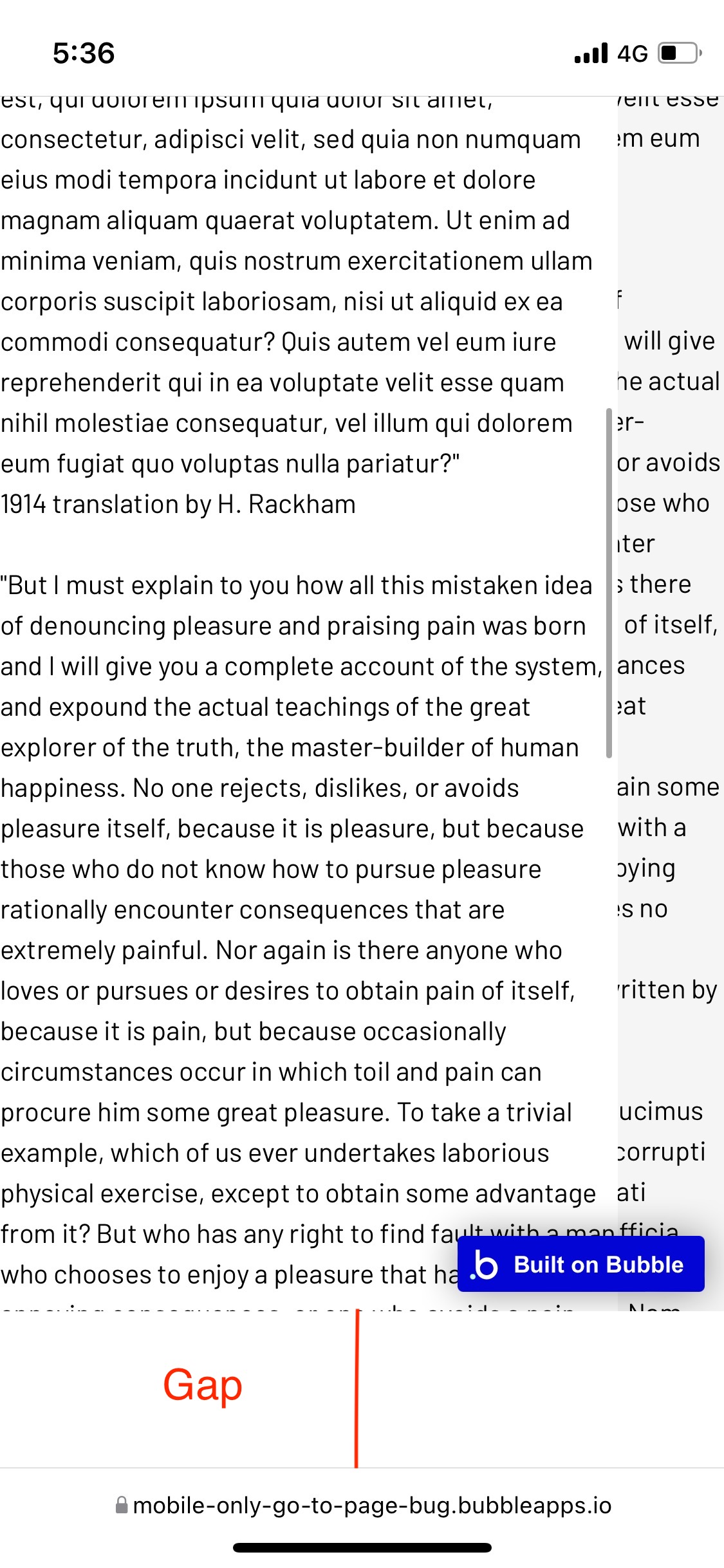

I am attempting to get this to function with a floating group, and I am seeing that on a mobile device the javascript running will cause the page height to decrease so that there is a large gap at the bottom of the page. When using a popup, that gap closes and the page height is back to normal, but when using a floating group, that gap doesn’t close and the page height remains with that gap.
I’ve tested this without showing the floating group or popup and the same issue occurs in that the javascript runs and causes a gap between bottom of content and page.
This happens when the user has scrolled the original text, then clicks the text to initiate the javascript workflow to run. As that javascript runs the height seems to resize and the gap appears.
This does not happen if the user had not scrolled the page at first.
Do you know of anything that could be done to make sure the floating group will cause the same expansion of the page the popup does?
