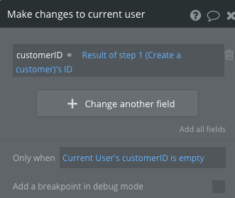

  1. Assign the customer ID to the user if need be
Screen Shot 2020-07-26 at 3.36.33 PM 1

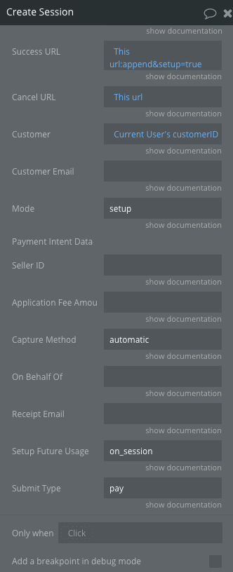

  1. I then create a session and give the success URL a parameter setup being true that I will use later. I’m not sure the payment intent data is necessary.

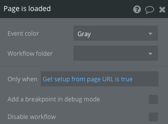

  1. When the page is loaded, I check if the setup parameter is true.
Screen Shot 2020-07-26 at 3.40.26 PM

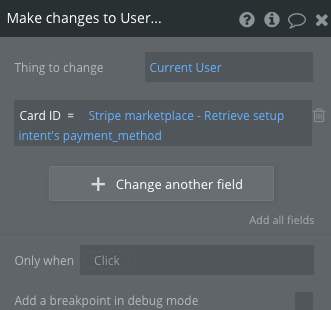

  1. Finally, I attached the payment method to the current user. (I might be able to directly take it from the previous step)
Screen Shot 2020-07-26 at 3.44.11 PM
