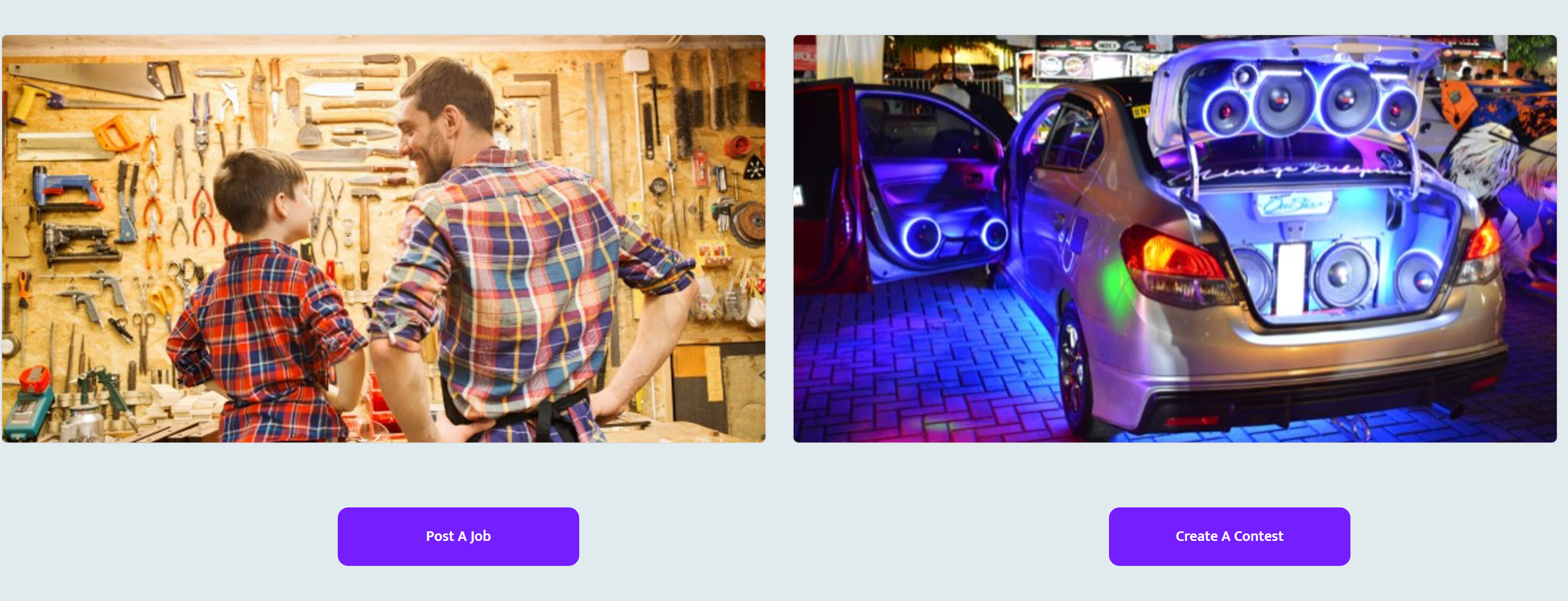

Two columns in a group messed up when shrink
Each column includes the image and the button. When the page shrinks, it becomes messy
Can anyone please tell me how to make the right image go under the left button?

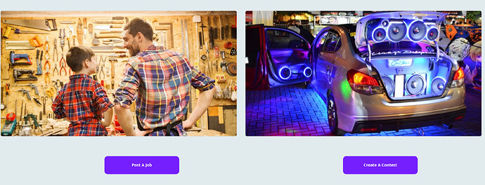

Hi Rajit, thank you so much for the detailed instructions! It worked well after doing it according to the steps. The only problem is the buttons are aligned to the left rather than the middle. I’ve double-checked the buttons were centred horizontally. It is acceptable but I’m just wondering if there is a way to force the buttons to the centre?
