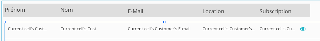

However, I am stuck when I want to display the subscription type next to some client’s data in a repeating group.
I want to display in my home page a repeating group with the following information (see screenshot) :
First Name / Last Name / Email / Location - Customer (data available in the data type customer & Subscription (yes/no) - (data available in the data type service)
In my database, I have linked the service with the customer with the email address (created in service a field with the field type : customer).

This is definitely possible! There are two ways you can find that information based on how you linked your records… FIrst, you might consider adding a field to the Customer data type that links to the corresponding service record. If you were to do that, you could use a dynamic expression like current cell’s customer’s service’s x.
It’s still possible to do this though without adding that field. Instead, your dynamic expression might be something like do a search for services (where customer = current cell’s customer):first item (since searches yield lists and we only want to look at one record)'s x.
Give it a try and don’t hesitate to reach out with any additional questions to Support@Bubble.io

The solution “do a search for x” worked perfectly for me.
