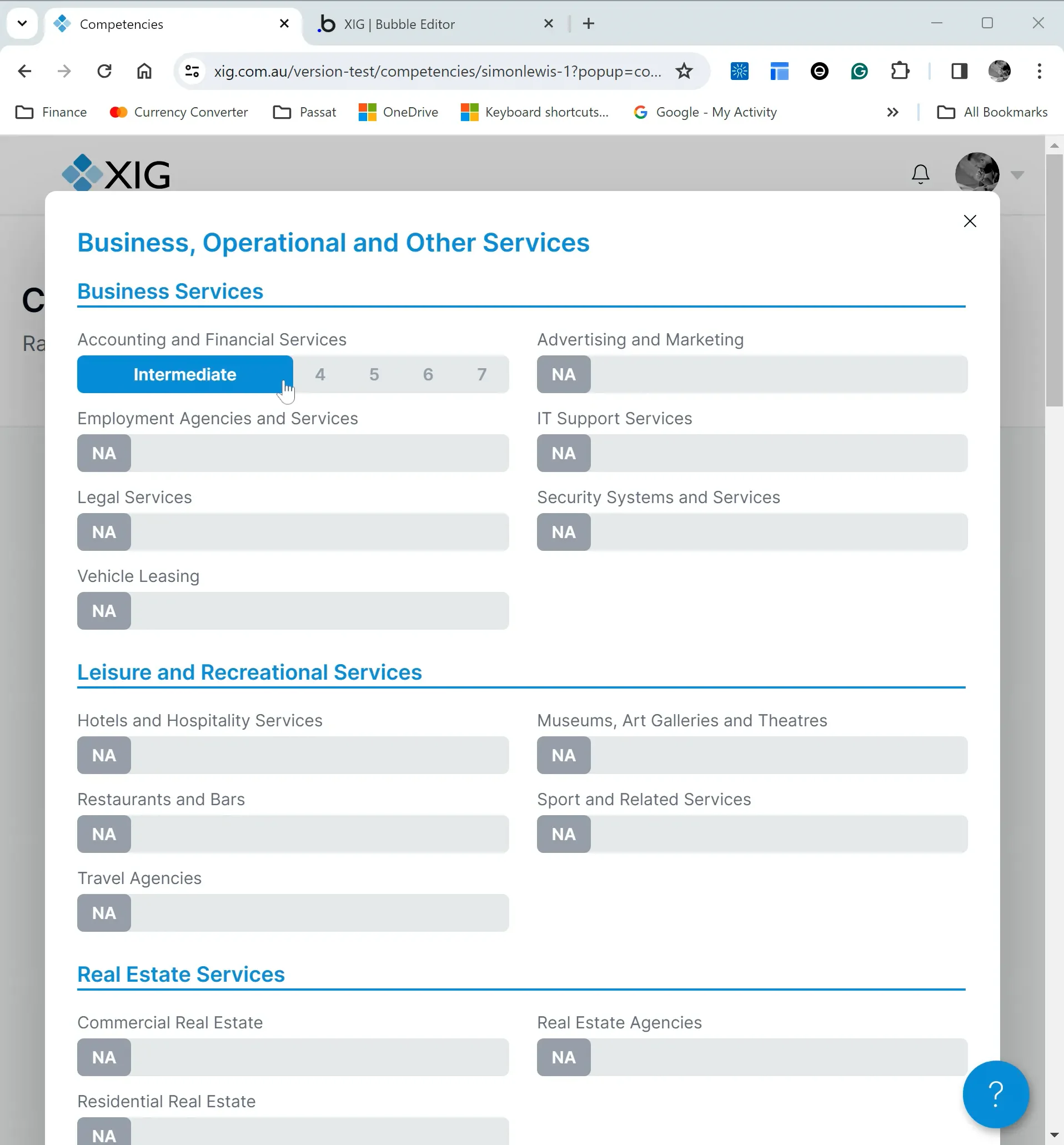

I have a number of buttons on my site whose states are connected to database values in the back end. When a button is pushed, it updates the database, and the states of the other buttons are reflective of the new DB value.
I’ve used “when button x is pushed” conditional statements to keep the UI snappy, which works as expected. However, when the button is released there’s a delay in updating the DB, so the states of all the buttons revert back to their initial state then update to what they should be.
If I remove the “button is pushed” conditions, the UI is slow to update (as it needs the DB to update first), so I’m either stuck with what looks like a slow UI or a glitchy UI.
I’ve tried setting temporary overrides (e.g. with element states or displaying data in a parent group) before doing the DB updates (either in a front end or back end workflow), but nothing I do seems to fix the issue.

It’s a bit tricky to describe, but I’ll give it a go…
I’ve set up some pseudo-sliders, which are stacked buttons, with some hover states, etc. to work like a slider but look how I need.
So, essentially clicking on a button just updates the database with the value and the other buttons stacked on top or behind go invisible, leaving the one that’s clicked.
You can see in the attached video, I’ll make some selections, which revert to their original state before the DB updates and information is sent back to the UI.
I hope that helps explain it a little better.

I would take the approach of custom state or displaying the value, obviously exactly how thats set up is based on if you’re using option sets etc, but you mentioned you’ve tried some workarounds but it hasnt helped?
I would think that as long as youre swapping from displaying the DB value, and instead displaying your current value, there should be no lag between the two.
For example if i put a group in a hidden popup, called it Var - business services Q1 and made its type number, left it blank, then put a conditional rule that if this was blank the data source would be pulling from the DB. Then when the user clicks a button i would display the number in that field and also kick off the WF to change the DB value. That shouldnt give any glitches I believe?

I’ve actually tried what you’ve suggested with the wrapper storing a variable which is referred to (rather than the DB value) when the button is clicked (i.e. step 1). If the variable is empty, the DB value is used:
Still, for whatever reason, there seems to be enough of a delay in storing the variable that I still have the same issue.
I’ve tried adding a delay between steps 1 and 2 as well as moving steps 2 and 3 to a backend WF to keep the front end snappy, but still seem to run into the same problem.
Of course, the problem might be related to the dev environment being a little slow at times…
