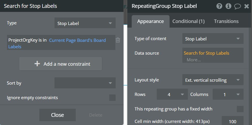

My repeating group is set to search for labels with the constraint ProjectOrgKey is in the relevant DB field for the Project’s Board (which is a list).
The issue I have is that the Default labels return fine, but the custom ones never show up.
Am I understanding/using the right kind of constraint? I’ve tried ‘contains’ too, but that returns no labels at all.

And here’s my constraint Ccnfig for the repeating group:
Let me know if that’s enough info to see what’s going on :slight_smile:
I set up an example on my end that looks very similar to yours, and it works fine. Still willing to take a look under the hood if you want, but here are some things that come to mind… what is the conditional on the repeating group? Is the current page’s board populating correctly? Are there any privacy rules in place that could be getting in the way? Have you checked the debugger to see if you can get any hints there?

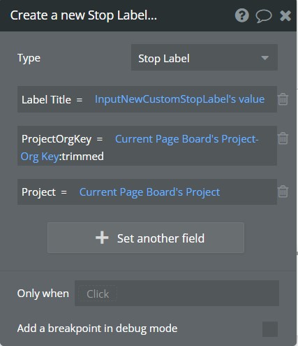

The issue appears to be that when I set the ProjectOrgKey for the new custom label (using the Board’s Project Org Key to populate the value) the application is appending a trailing space to the value - obviously, this means they don’t match when it evaluates the constraint. If I go into the database and delete the trailing space from the end of the label’s ProjectOrgKey value, the label shows up in the UI.
Is there a way to avoid this behavior when setting one value based on another? Kind of like a ‘Trim’ function? Seems very odd that a trailing space would be added TBF, so perhaps there’s something odd that I’ve done when setting the value.

I think the trouble with that is that (if I’m reading this right) then the trim is being applied to the wrong entity. It’s the Stop Label’s ProjectOrgKey that has the trailing space, not the Board’s

I had a look but I can;t seem to see a way of implementing the trim at the point of setting the label’s ProjectOrgKey attribute (which would feel like a nicer solution - I’m certain this will catch me out again if there are more scenarios where a traioling space is added :slight_smile: ) Any tips?
Appreciate the help so far!
Yeah, that sounds like exactly what you need to do… not sure why you can’t do it, though. Can you tell why the space is being added in the first place?
It’s highly likely to be user error :slight_smile:
When I try to add it at the point of creation, it doesn’t seem to recognise it as an operator and just appends the test ‘:trimmed’
lab6
I’ve gotten things working by adding a new step which immediately make a change to the Thing, setting the value to the trimmed version.
lab5
Doesn’t seem very elegant, but it works :slight_smile:
Try copying the expression in the second screenshot into the first screenshot. :slight_smile:
Worked a treat, thanks!
