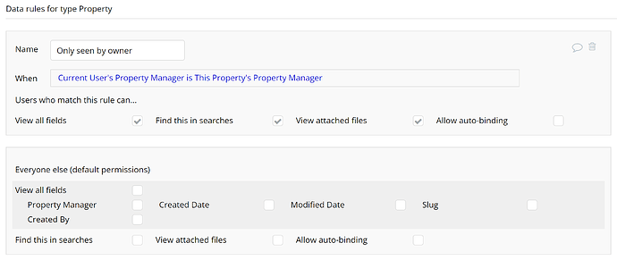

Since the property entity will be used in the url for navigation, my main concern is security so that you can’t just put in the SN of the property and you access an account that isn’t yours. Is this even a concern or just handled in the privacy settings?
