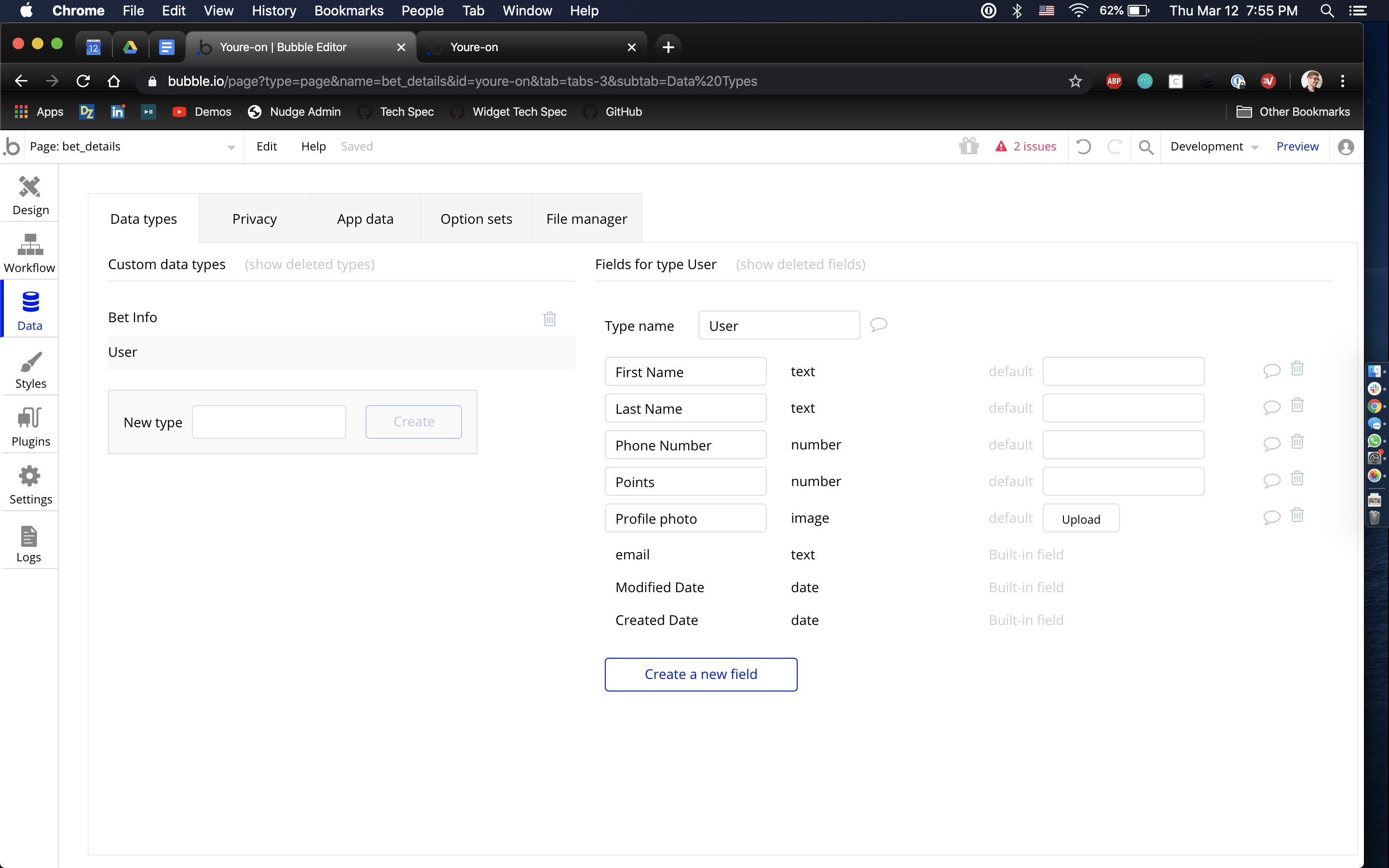

I have one Data Type called Bet Info and in there it has a list of “winners” and “winners points” as well as “losers” and “losers points” my other Data Type is Users and in there I have “points” (screen shots below). Very simply I want to:
  1. For users who are “winners” add “winners points” to users existing “points”
  2. For users who are “losers” subtract “losers points” from users existing “points”

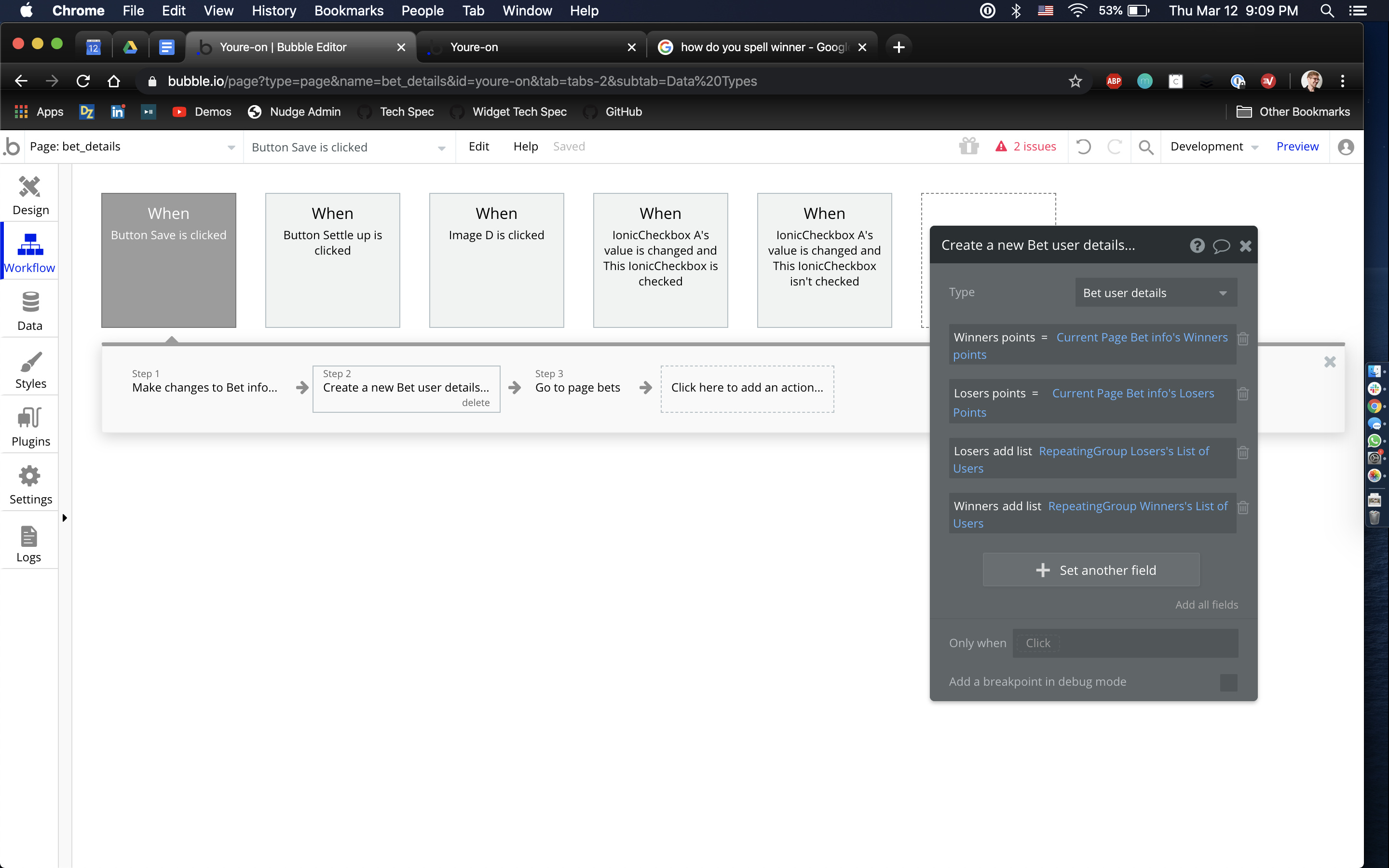

Please help! I’m not sure where to do this calculation. I have tried adding it to the workflow when we close the bet and update who the “winners” and “losers” are but I can’t seem to get the formula right (see below).
And I have tried adding it to the profile page, but it doesn’t sum the “winners points” it just lists them (screen shots below).
Thanks!

I have a few questions. What do you mean by “link” for the fields? I created the data set as you can see below. Is that what you had in mind?
I’m still a bit confused as to how I do the calculation when I close out the bet. I’ve added a step in the workflow to add the winners points and the losers points to my new Data Type “Bet user details” but still not sure how to tie that to a calculation to update the winners and losers points.

I believe your next step will be to set up a backend workflow to create a list of bet details. You will need a new record for each user and whether they are a winner or loser, and the associated points. Again, I don’t think you can achieve what you are trying with a list of users.
