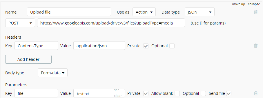

I am building an app that can upload files (pdf, png, jpg, docx, xlsx, pptx, etc.) to Google Drive.
I used the following Drive API for uploading.
When I sent the file as binary with Postman, the uploading succeeded and the file could be opened in Drive.
(But why is the file name “Untitled”?)
However, I can’t send binary by API Connector, right? I tried to send a file as form-data.
As a result, a response is returned, but the uploaded file cannot be opened in Google Drive.
googledrive_unsuccessful
(I did not set Content-Length because adding it would cause timeout.)
Is it possible to upload files from Bubble to Google Drive? Any advice would be appreciated.
Thanks.
Pretty sure when you upload a file you have to include its MimeType. I can see you’re MimeType is wrong when you’re file is Uploaded. It should be “text/plain”.
Thanks for your reply.
Yeah, I tried to upload the file with Content-Type as text/plain, but the result was the same as when I set it as application/json.
Both examples I see you’re using “application/json”. It must be “text/plain” for that type of file.
I’m not sure otherwise.
Thanks for the reply.
I did not attach an image, but I have also checked with text/plain. The result is the same as when set to application/json.
Your data type must be a file as well
Thank you! I tried it and this is the result…
Okay. Try this:
{ "parents": [ "<folderId>" ] , "mimeType": "<mimeType>", "name": "<fileName>" }
Use “Content-type: application/json” in your header like you were doing, use JSON as data type.
Use RAW body type.
In properties that have been created below:
Add your mimeType “text/plain” value.
Add your folderID “drive folder ID” value.
Add your fileName “output drive file name” value.
