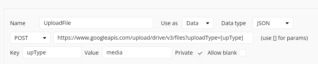

I’m looking for some help uploading files to Google Drive from Bubble. I’ve been through the pain of setting up OAuth and have that all working so now I’m trying to setup the API call and test. I’ve not found much in the way of help on this so far so probably a long way off but this is the confg and error. Any help appreciated
Hey Zenziblesolutions, in the documentation it says uploadType should to be a url-parameter, so try it like this:
Or try this:
By using brackets [value] you can set the value of the parameter. To be able to set it later in the workflow, remember to uncheck the Private option.
Thanks for the response. I’ve tried both of those and get the same error. I’m not sure wha’s wrong, the error message doesn’t give much away.
