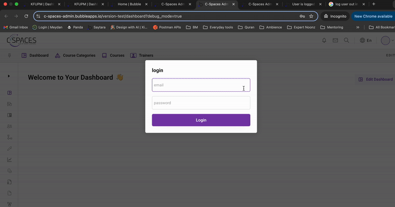

Hello. May i ask you for help? The workflow that triggers when user is logged in is not working. I recorded a video to explain No name - 30 June 2025 | Loom

But the thing - it’s working when page is loaded. It’s not working when page is already loaded and popup is visible. User is logged in, but the workflow is not running.

Thank you, i did tried this. It’s just ignoring this workflow, even if i will do it every one second. Here is video No name - 3 July 2025 | Loom
that is because in your case the popup shows already in all tabs when the user logs out. The page does not hide the popup unless the login status is checked while the popup is visible and the user isn’t interacting with it. So refresh the page every x seconds if the popup is visible and the input is empty. the popup should be hidden then.
Popup does not shows, that’s the problem. The workflow is not running when user is logged out.
Did you tried the thing you suggested? It’s not working, as it’s shown in a video
I did and it worked for me. but if it still doesn’t for you, there is an easier way, you can add a session control field to the user and edit that when you log in or out.

I tried your method and it seems like there is no reaction No name - 7 July 2025 | Loom
I don’t understand how it’s work for you, since if current user is logged out we can’t access the field for that user
it’s exactly the point. since the page doesn’t refresh it doesn’t know the user is logged out, so you use a field in the user datatype which you update when you log out in another tab to check for login state and refresh if required.
“Current User that is logged in” is different user than “Current User logged out”. They have different records and different unique_id.
So in theory the situation may happen when user is logged in, but has a field where he is logged out.
we are using a session property of user. we are not using logged in or logout statuses because again, the page does not know that status without refresh. If you like you can share an editor link I can set up for you. but otherwise I really can’t explain it more.
I understand what you talking about. The problem with your solution - it might not always work. Please review the video. You will clearly see - logged out user is not logged in user, it’s 2 different id’s Logged in and logged out user | Loom
If there are 2 different records in database - logged out and logged in - you don’t know which one’s field you modified.
