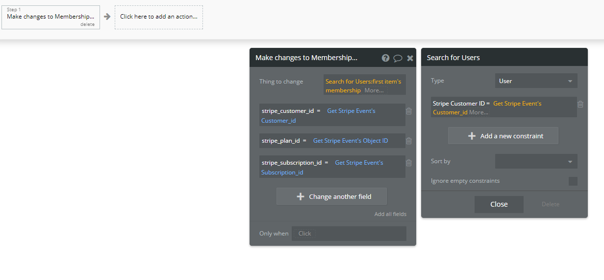

In the work flow for this webhook, when the webhook is called and a user goes through the purchase and then a subscription is created, i want to add the customer id, plan id, and subscription ID to the membership so I used the event ID and stripes get data from external API as follows:

Make your API endpoint “request data” instead of manual definition. Bubble will provide you a URL to give to Stripe to send the first test webhook. Send a test webhook through Stripe and you’ll then see the data in bubble. You might want to check out our Stripe Webhooks tutorial at nocodify.com for more help.
Tal
After experimenting and testing I’ve got both ways to work in terms of calling the webhook and capturing data.
In a production or live environment, are people running this ignoring privacy and authentication or is there another step to authenticate correctly?
