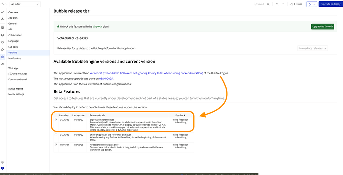

First, here is how you add brackets:
Second, I don’t recommend using Advanced Filtering. Maybe try to adjust your database so you don’t have to do advanced filtering. It will be heavy on Workload. :blush:

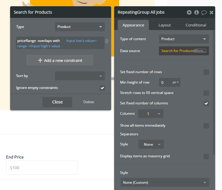

I am all for performance :), so how would you approach the situation where I need to match ranges?
My Listing may have an exact price (34 dollars) or may have a range (25-50$).
User searching will enter range (36-55). I need to filter all listings where exact price will fall into the searched range OR any part of the listing’s range will fall into searched range.
Again ChatGTP suggested the following (again with brackets LOL). What is the best practice for something like this? :

Is this what you are looking to do? Have them search for a product that has a price range with a price range?

Yes! That is it. Thank you VERY much. this is much simpler and cleaner then what i had.
For the other people who will be looking for an answer.
priceRange is a field on Product with the type of “numeric range”
