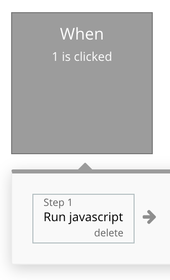

I’m using the Javascript plugin from Bubble to try to fire a conversion for when something is clicked:
Normally, you’d include the Google Ads click tracker as an onClick element. I’m trying to do this:
Which throws an “invalid return statement” error.
When I wrap it in a function, I get an “invalid or unexpected token” error:
Any idea how to make this work properly?

I now have the tracking event running properly, except: now when a user clicks the item in question, the event script fires, but also a dialogue of “Leave site? You’ll lose any unsaved changes.” pops up. Any idea why that might be occurring?

Yes, I ran into exactly the same issue with a Stripe integration. Disabling / removing the handler for the beforeunload event resolved it for me. See if adding the following to the start of your script solves the problem:
window.onbeforeunload = null
