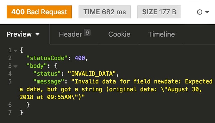

I originally tried to use a Bubble “date” data type to receive the time, but ran into trouble because of a mismatch in format:
IFTTT sends the date like this: “August 30, 2018 at 09:55AM” where Bubble expects something different as the reference explains:
2) **Dates:** Send a date as a string or timestamp. For example, 'Wed Jan 13 2016,' '01/13/2016,' 'Wed Jan 13 2016 16:45:09 GMT-0500 (EST),' or '1453398788637.'
When I tried to send it to a date field, I got this error:
Presumably this can be solved by doing some processing on the text string, which I wish was easier in Bubble :frowning_face:
