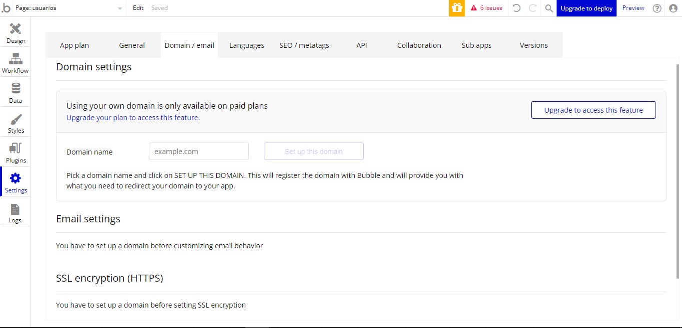

Thanks for your answer. I’m using Bubbles embedded “Send an email to confirm the email” option, I don’t see a From field there.
My Settings > Email/Domain don’t show this From option, either. :thinking:

The app I used as a template is a paid app. In that app, I have set the From field, under Options >> Domain / email >> Sender name. Then, my new app, which is not paid, inherited the Sender’s name from that app and now, as this new one is not paid, therefore editing the From field is not allowed, I can’t change it to what I want, and I’m stuck with the name of the template.

Oh… you’re not on a paid plan. Yep. That would explain it, I’m pretty sure you can’t change the Sender Name if you’re not on the paid plan
One more place you might want to check is under Languages in settings, but I don’t recall a field with sender name under there.
An alternative is to use another email API like Postmark to send your emails vs. the built-in Bubble sendgrid action
