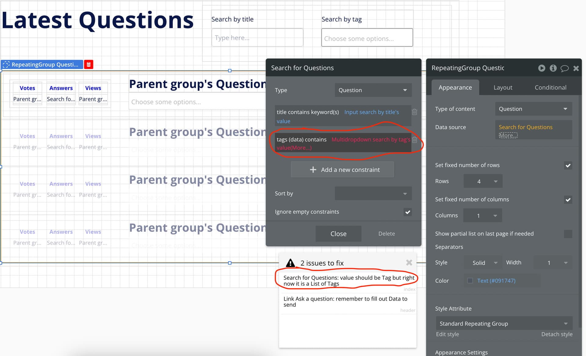

Value should be X but right now it's a list of X
Hi there! I’m working on a StackExchange clone as practice, and I wanted to add a search function that can filter the questions on the home page by title and tags. When I set the filter by title, there is no problem; it works perfectly fine, but when I try to do the same with tags, I am stuck with this problem:
Value should be Tag (option set) but right now it’s a List of Tag (option set)s
I would be grateful for any help!

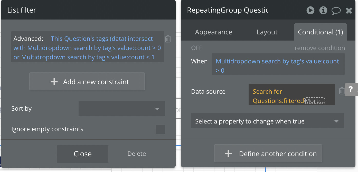

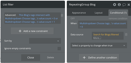

Something like this:
So we use as much simple constraints in Do a search expression as we can for server-side filtering, then apply :filtered operator where at the bottom there is an Advanced: option.
Within this advanced option we make an expression like This Thing's list of values INTERSECT WITH multidropdown's value:count>0.
The second part OR multidropdown's value:count<1 is used as a replacement of “ignore empty constraints” option that is not available in advanced filtering.

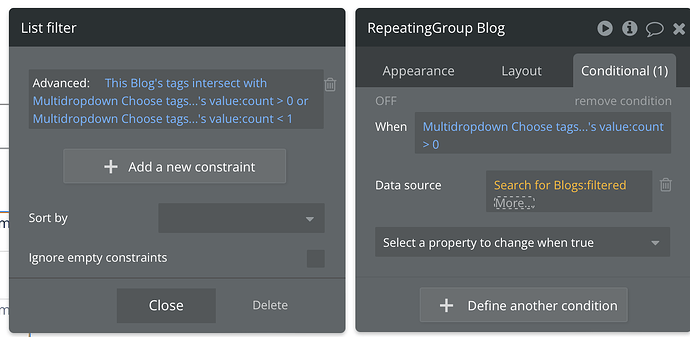

Thank you. Seems like now the tag filter works. But it created another issue.
Scenario: There are 100 questions with different tags. First I use the tag filter. Now there are 25 questions. Then I use the title filter (contains keyword) to find a specific question, but it doesn’t work. I can only filter with tag OR keyword.
Have you added your keyword constraint into Do a search expression that is advanced filtered later?
This is for tags.
This is for titles.
What did I do wrong?
(thank you for your help!)

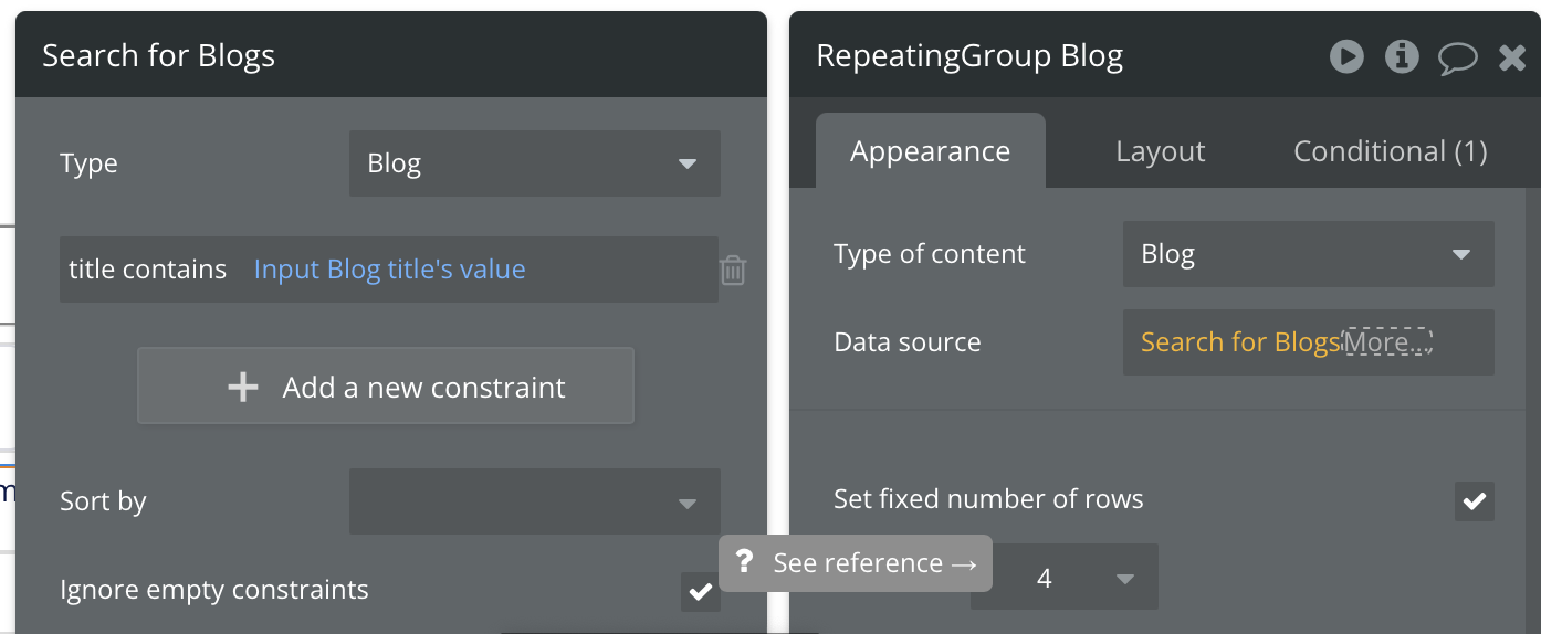

All constraints should be within 1 search expression.
And you should not to use Advanced for keyword search. Add constraint title contains input search by title's value right into Do a search expression:

First of all, I’m sorry for confusing you with setting data source in “Conditional” tab :slight_smile:
The reason for it is that as far as I remember if advanced filter is used in dynamic expression of the data source - it will lead to client-side filtering even if the list to compare with (from you multidropdown, for example) is empty. That’s a thing to double check cause I’ve tested it long-long ago.

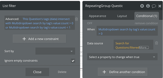

So you need to set up default Data Source (tab “Appearance”) like this (and don’t forget to check “ignore empty constraints” if you need your RG to show Things when 0 filters are applied):
And in “Conditionals” leave your expression as it is, but check “ignore empty constraints” too (in Do a search for constraints window).

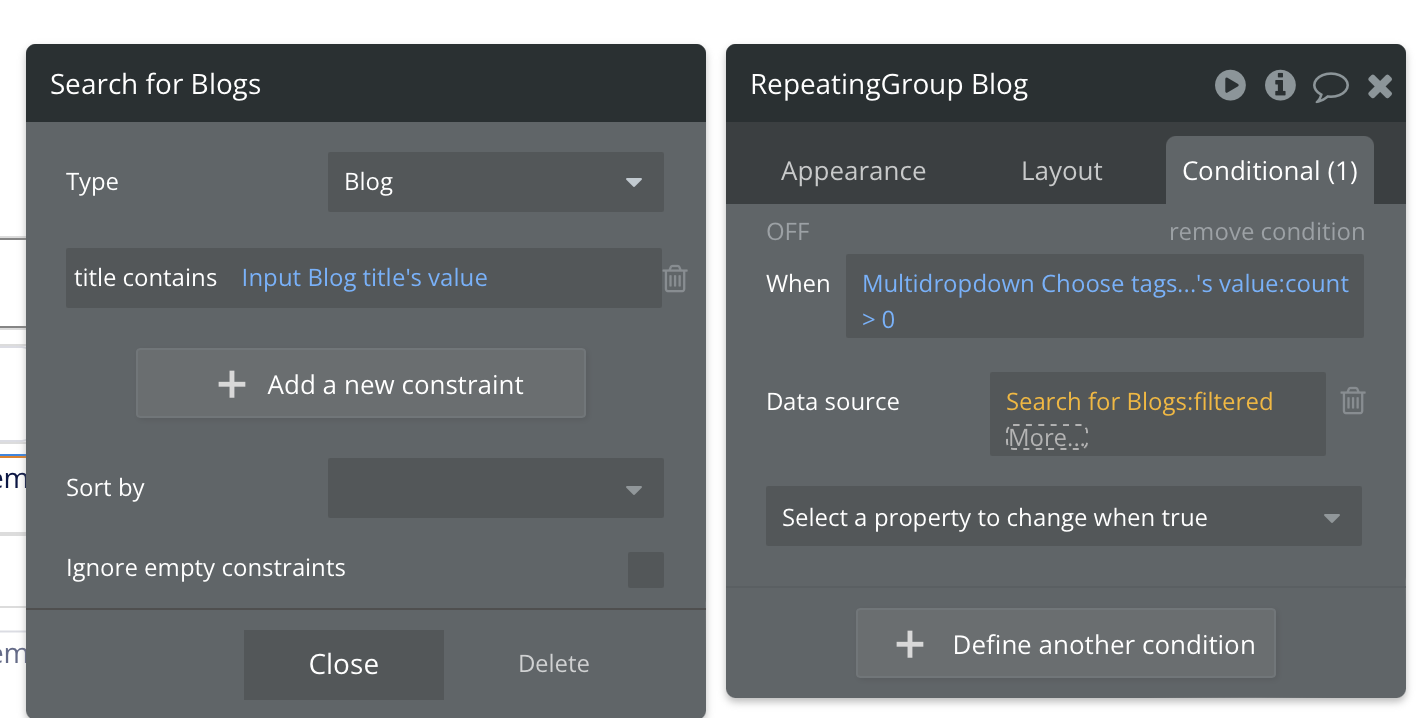

If you filter first with code, there will be two results and then also filter by title ‘Ruby’ let’s just say. It doesn’t filter down to one result.
Here are the settings now.
Have you left title contains input search by title's value in conditional Do a search?
No, but I fixed it and now it works :wink: The problem now is when I filter title with ‘under’ word (two questions contain this keyword) it doesn’t show anything
