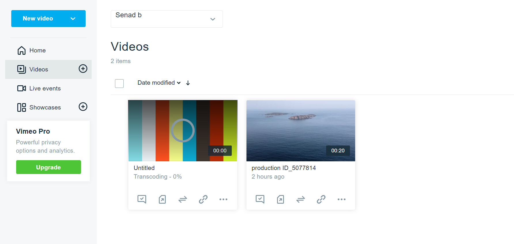

However, the video is not transcoded, its status remains fixed at 0% (first video):

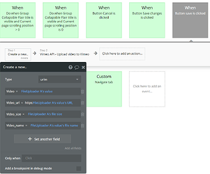

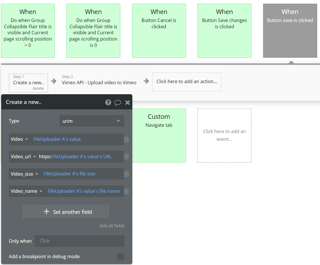

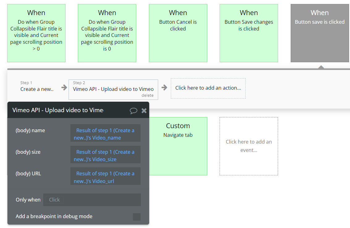

This is my workflow:
E.g. I cannot transcode this video URL

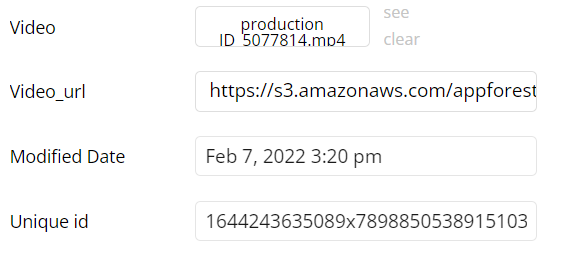

yes every time. the video that worked (in the picture) was uploaded manually from my computer files
Has the file been uploaded correctly to you Bubble storage?
yes, when I click ā€œseeā€ a new tab is opened and I can see the video (url is this)

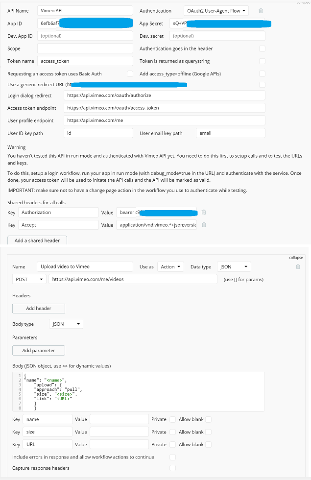

I notice in your screenshot of your API set up that you haven’t entered anything in the ā€˜scope’ field.
I’d have thought that was fairly important, so I’d try it again making sure you enter your allowed scopes in that field. I don’t know if that will help (I’m surprised the API call works at all without any valid scopes). So give that a try.
I’m assuming you’ve initialized the call in the API connector?..
So did it work then (i.e. was the video you used for initializing the call uploaded successfully to Vimeo?) If not, did you get any kind of error message in the call?
  1. I entered the scope (somehow had forgotten it) private edit upload public. Still not transcoding.
  2. Yes, I have initialized the API connector.
  3. Uploading to bubble works (i.e. when I click ā€œseeā€ in the pic above I can see the video). But, uploading to Vimeo does not, or at least it does (because I can see an entry) but it does not transcode. I did not get any error message.
So did it work then?
Yes, initializing the API works (see pic), but it is the video in Vimeo that is not transcoded

I have a question. Do you know what the Warning in the picture of this post refers to ā€œYou haven’t tested this API in run mode and authenticated with Vimeo API yet. You need to do this first to setup calls and to test the URLs and keysā€¦ā€.
I searched the forum and did not see a solution…
