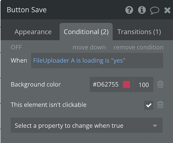

Hey,
what you could do is that your “save” button isn’t clickable as long as the picture / file is loading.
Here is a nice example I just built. As long as the file is uploading the Button has a different background color and isn’t clickable. This way, the user understands that he needs to wait and there can’t be an error in not saving the picture correctly.
https://testapp1biberei.bubbleapps.io/version-test/fileuploadtest?debug_mode=true
Hope that helps.
Top. thanks a lot! that was right under my nose.
