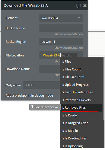

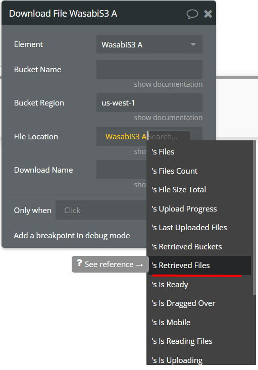

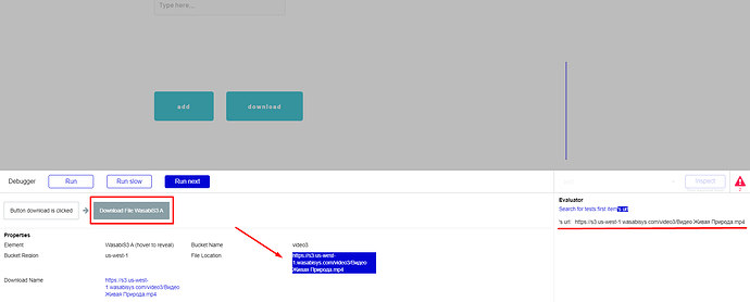

Good afternoon, I’m having trouble downloading a file from Wasabi( Please help me!

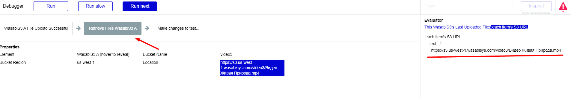

I enter the necessary data, in the input field “File Location”(pic1), but part of the file path shows an error “empty” (pic2) and an empty file is downloaded, although I write the same path to the file with the command “Delete Files/Folders” and everything works (pic3). How can I solve this problem?
Hi @volkova_n2, thanks for your message.
Within the “Download file” action, please refer to the “retrieved files”
This should file the issue.
Please let us know if it worked in your case or any other support is required.
Regards,
Zeroqode Support Team
Thank you very much for response, but unfortunately this did not solve my problem( The path to the file is still empty, but the file is definitely there

Hi @volkova_n2, thank you for your patience.
Please be sure that you also use the “Retrieve files” action, so the “Download file” action has files to work with.
In case if the issue will persist, for its better understanding, please share (here or in DM) a screencast or some screenshots with each step of the desired workflow.
Regards,

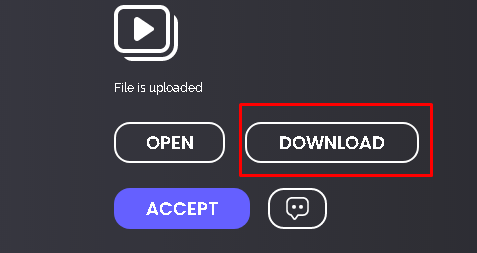

Good afternoon, I still can’t get the desired result of downloading the file from Wasabi :frowning:
I follow the following steps to download the file:
  1. I press the “Download” button (Pic1)
  2. I perform the step “Download File WasabiS3” and specify the path for the file that is relevant for other actions (Delete Files/Folders WasabiS3 and Wasabi - Generate Presigned URL) (Pic2)
  3. I get an empty file instead of the one in the Wasabi folder (Pic3)
Hi @volkova_n2, thank you for your message.
We’ve prepared a small example of the download file workflow, that might be useful for your case: Appkit | Bubble Editor
It works for files that have been recently uploaded.
In the case of your setup, you indicate each item, which is not correct, because it transmits a list, and the requirement is for 1 value only. Hope it will helps.

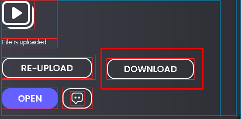

Thanks for your reply, I forgot to specify that I need to download the video file. I tried to download the video, but I got this error (Pic1) However, the video is downloading and I can watch it.
Also I need to download a file which was uploaded to Wasabi database earlier (e.g. one day ago) on another user’s page (who didn’t do the video download) (Pic2)
For your case, to retrieve an earlier uploaded file, you can use one of the options below:
  1. You can save the URLs or data about files (bucket and nave of the folder for example) for all uploaded files in the Bubble database and use them for later download.
  2. Before downloading the file, at first - you can use the action “Retrieve files” and then use the state " Last retrieved files" in order to get the list of files in a RG or text element, that can be managed and used to filter the name of retrieved files as it is required by the project (uploaded a certain period of time ago)
Thank you for the provided image, we’ve passed it to the developer team for investigation. Once any news will appear in this regard, we will let you know.

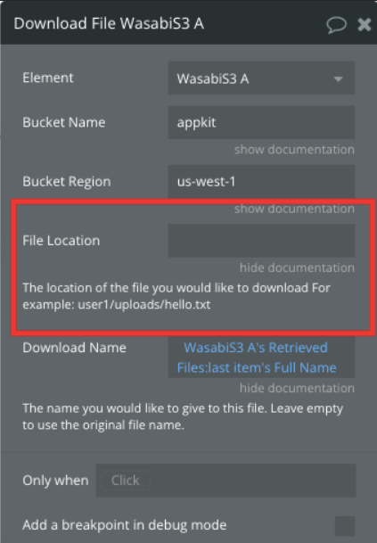

Hi @volkova_n2, thanks for your patience :pray:
Please check if you have indicated information in the following field (full path to the file and it’s name)
If the issue will persist, please share screenshots with the plugin element setup and related workflows.
