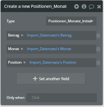

What does your backend workflow look like? You need to schedule a backend workflow on a list of the type you want to copy, then, inside the workflow, Create a new (new data type) using the fields of the other data type.
Thanks for your reply. This is my workflow.
Thanks for your help.
If you need further informations to the workflow please ask.
Thanks.
Patrik

It doesn’t look wrong from the screenshots, but what we are saying is that “List to run on” might be empty, hence nothing gets copied.
Can you make sure that there is data that you are passing to that list? You might have privacy settings enabled on that table or a search constraint that’s too restrictive.

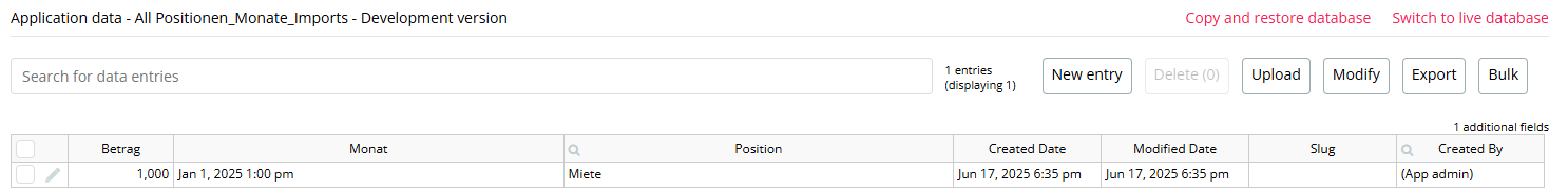

Opening App data shows me that the data type contains data. So the list is not empty.
