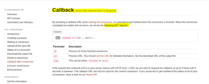

+1 also. I’m stuck for implementing the full CloudConvert API because the callback is done as a GET request on the endpoint :
@Bubble
Can you tell us if it on the roadmap or a workaround such as using Amazon API Gateway is necessary with Bubble ?

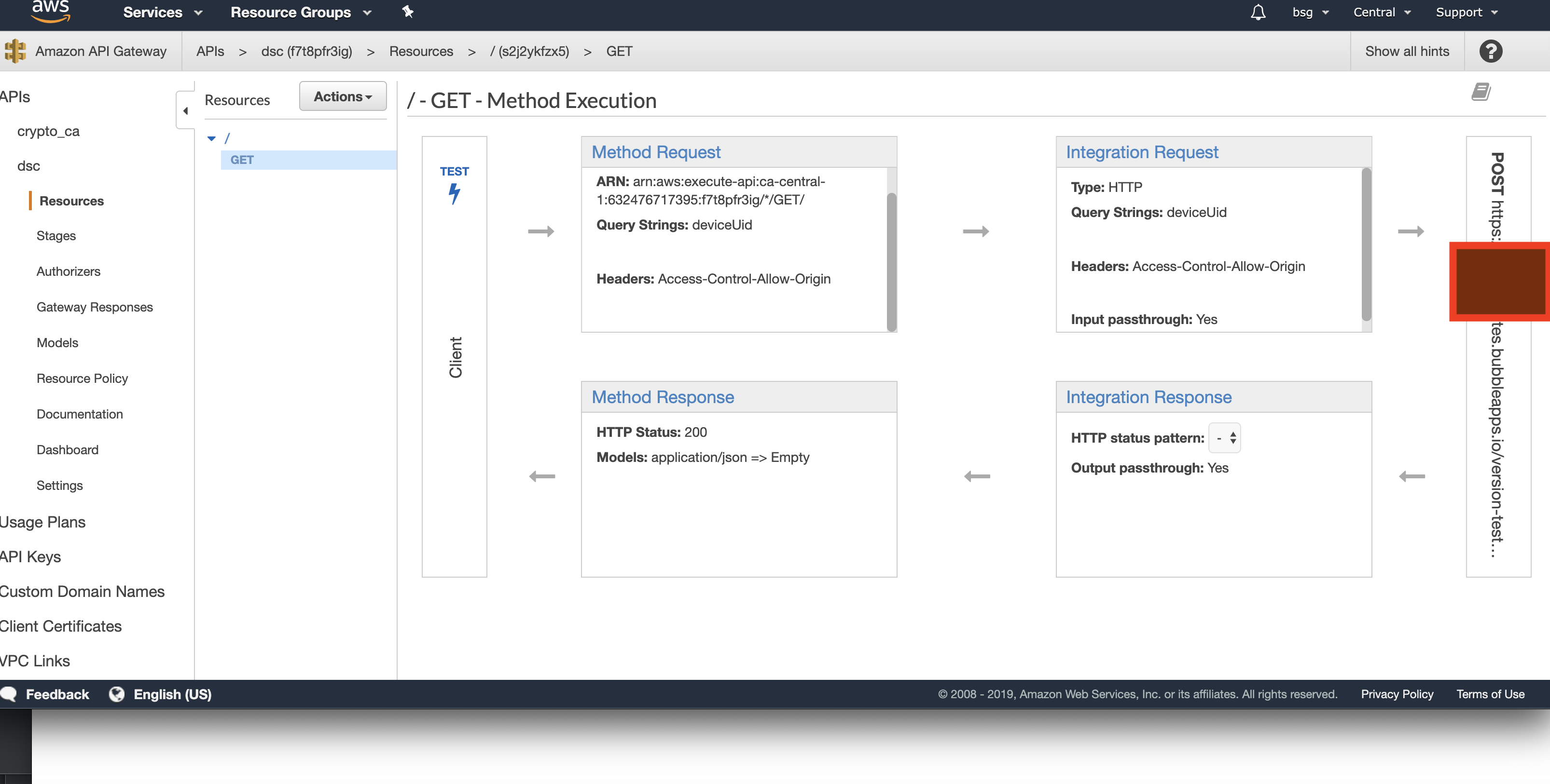

For the time being you can just use AWS Api Gateway. Make a endpoint using the GET method and integrate it with Bubbles POST request to your workflow. It will take your bubbles post request response and forwarded it as a response of the actual GET request

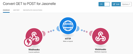

Hi @vladlarin
As an alternative, I use Integromat automation to convert the GET to POST and send to Bubble.
Thank you @JohnMark! Will try this out and let this thread know if this worked for our case!
Hey let me know should you have any queries regarding Integromat! :slight_smile:

Hey @keith & @shawn.chaudhery Have you been able to return header using Gateway API? my return json looks good otherwise but I’m struggling to get the header.
Hey @keith, can you provide more details on how you did the Amazon API gateway setup? I’m trying to convert a GET from Facebook webhook to a POST that Bubble accepts, and struggling a bit with the setup, specifically with defining querystrings.
