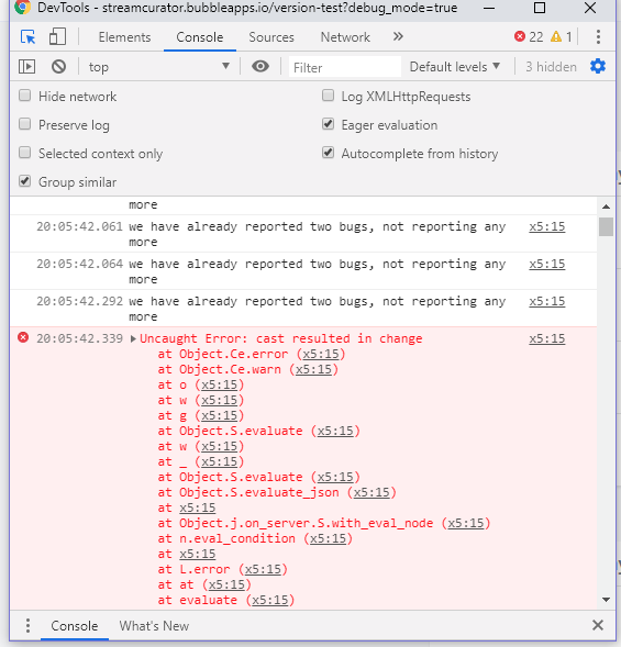

@Bubble: Now I’m getting furious, actually: This error is OBNOXIOUS. KNOCK IT THE FUCK OFF. This screen snip is from not the plug I’m working on but from something else I’m trying to reference here in the forum:
EVERY SINGLE APP throws these all over the place and it is impossible to see anything in the console. This is so insanely rude that it borders on sociopathic. QUIT BOGARTING THE CONSOLE.
Apparently you cast types all over the place. Yippee! You can stop informing yourselves of this.
