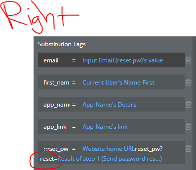

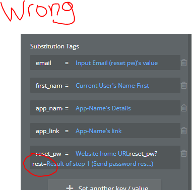

I was having the same issue and it turns out, for me, I had one of the substitution tags misspelled:
