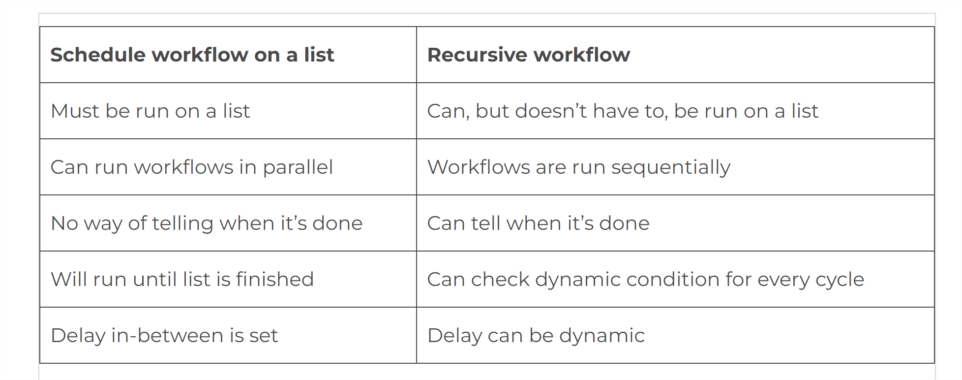

Source : Part 1: How to set up Recursive Workflows - Amlie Solutions
Is this still true? Knowing when it’s done can be quite important.
All true. But something not mentionned here are WU (a lot more with recursive vs sawol) and also racing issue that could happen. For racing issue, this could be solved in most case by increasing delay between each item. Finally, API rate limit is something to consider when running on a list.
Also, this documentation is probably not up to date with recent sawol update and pricing change.
