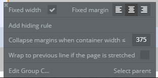

  1. Go into responsive mode and make sure the group fixed margin is set to center:

  1. The page should be black and not fixed width. The group will be fixed width, as you said above.

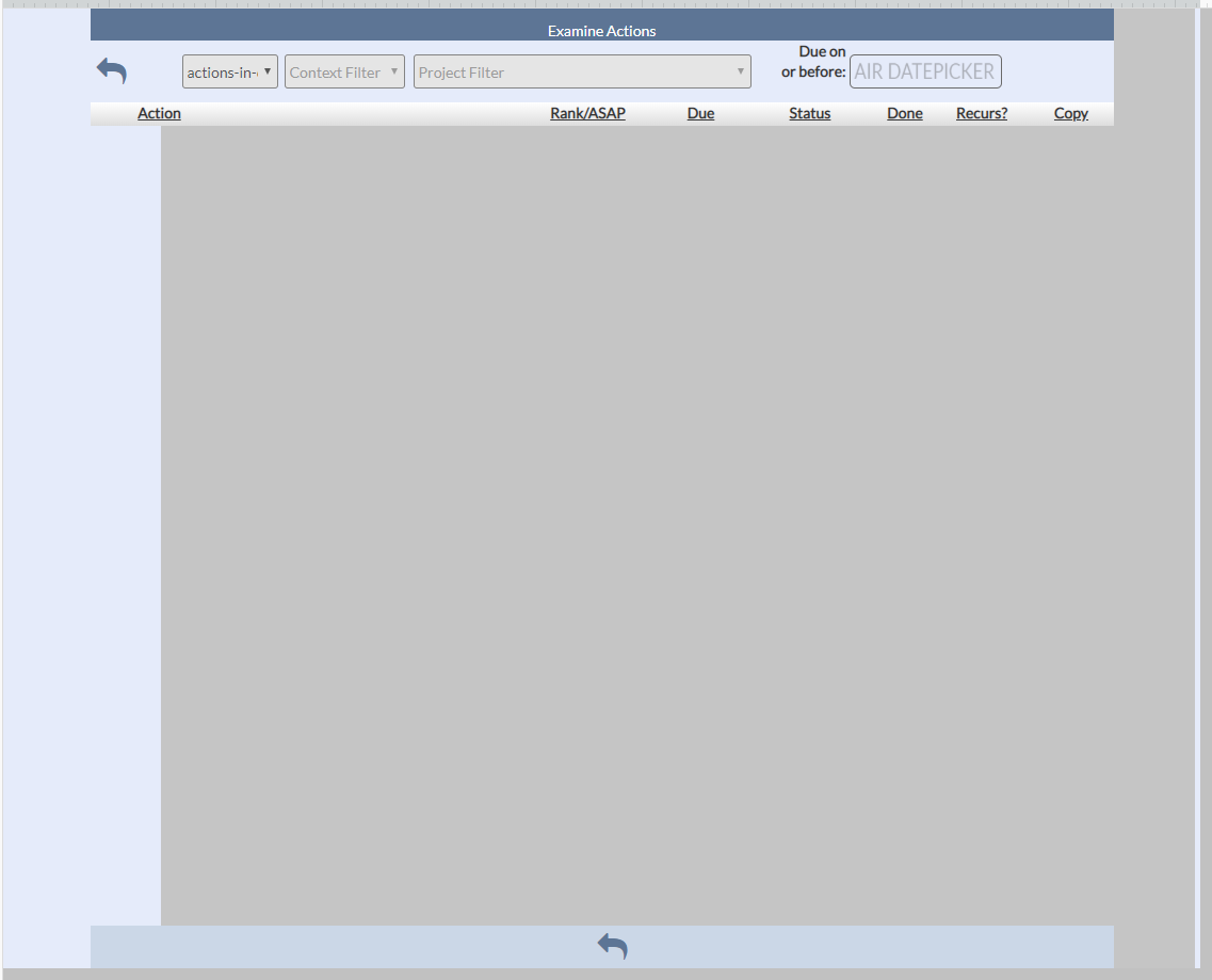

I have other pages that are not keeping the body centered as designed. Example:
In my application, I use a floating header and footer, and they always remain positioned properly.
I’ve removed all elements from within the body group. Otherwise the Bubble specification for the page and body group are like the other pages that do work.
However, the body (gray) is stuck to the right edge as seen in Responsiveness mode:
The floating header and footer remain centered as they should, but the body is behaving as though right-aligned.
This seems to happen randomly after doing a fair bit of work on a page that once worked properly.
Do I need to build an all new page with a fixed body group that remains centered and then copy everything else from the defective page into the new one?
Is there a way to tell Bubble to re-evaluate a page to fix this kind of thing?
Are there other elements on the page the body group is overlapping with?
Right now, the page is pretty simple.
Group C is the one that is supposed to be centered but sticks to the right.
floatHeader and floatFooter completely contain their elements.
popSignupLogin, repopAddAction and repopDeleteAction are reusable popup elements with no particular positioning. (I think :confused:)
reAction is a reusable element with workflows but no contained elements. It is positioned at 4/1.
Unless you have another suggestion, I’ll start removing elements one at a time and test them until Group C is the only one left. I have a couple of other fires raging, so I won’t get to this for a few hours.
Andrew,
Here’s what I’ve uncovered:
Perhaps a bug. Perhaps a subtle oddity of responsive behavior. Perhaps it isn’t even duplicatable by others and is the result of how I built the page over time.
In any case, I now have some idea of what to look for when my pages are misaligned.
