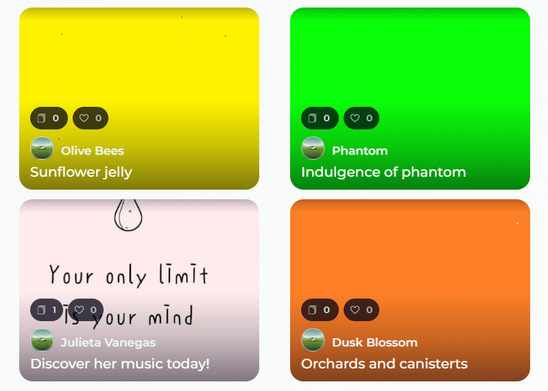

I don’t know why the search would be so heavy since I’m not retrieving anything complex from the businesses itself other than a few simple fields like its name, description, profile picture and such… which based on what you guys said above, it shouldn’t mean any other lists are pulled up correct? It’s a very simple layout to show just the very basic info of businesses:
