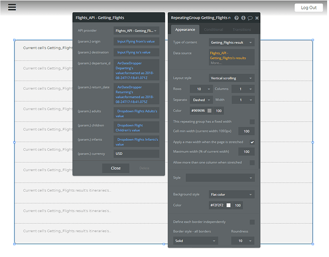

So I’m sure the API, key and the params are all working fine, so within my application I did the following:
I started setting up the group first as I did with my previous APIs;
I did the repeating Group as follow:

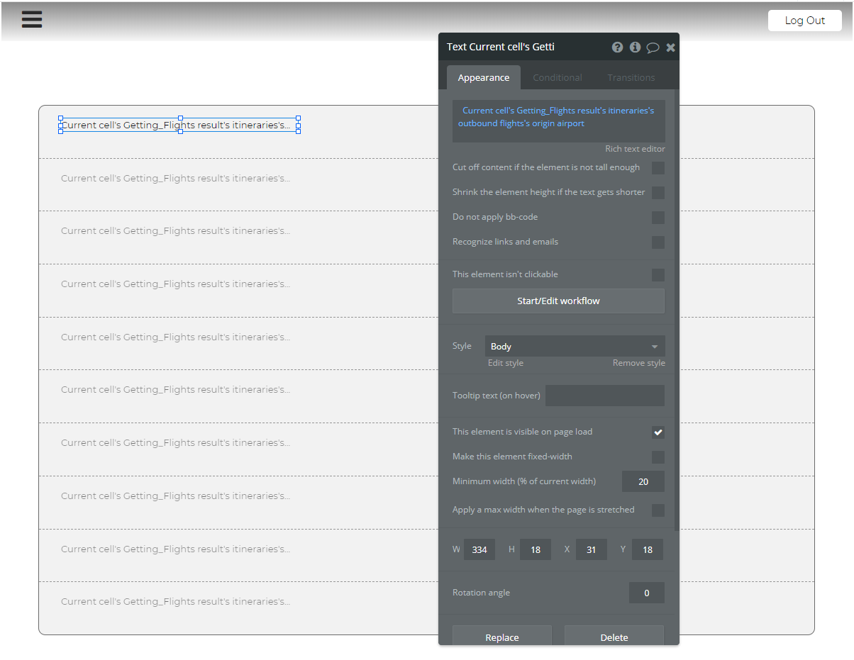

And for displaying API response data on the repeating group I did the following:
So similar sitting for the other APIs I’m still using in this app… but this is what I’m getting as a response even though all the requests show response status; 200 I still get empty response:
I’ve tried different things but the results are always the same.

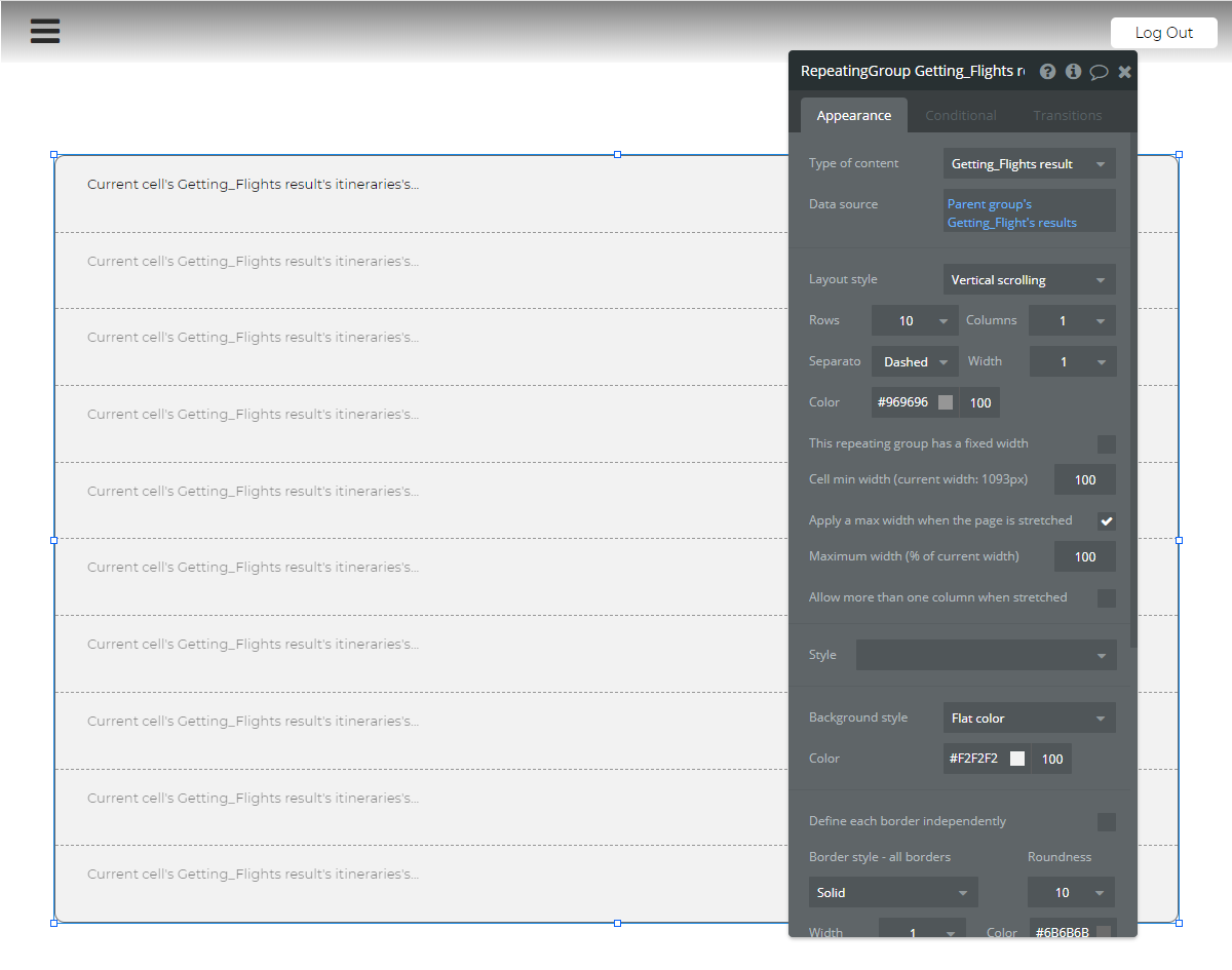

Based on a quick look, it looks like you defined the data source on the parent group first and then displayed the results in the repeating group.
Try setting your data source to return results in the repeating group itself. (Ie. what you have as the Data Source on “Group Flight Results” move to “RepeatingGroup Getting_Flights…”
Thank you Dan for your quick response.
Ok I will try it right now…
Thank you again
I just did what you’ve told me:
then:
but still showing no results!!! it must be something else that I’m still doing wrong…
