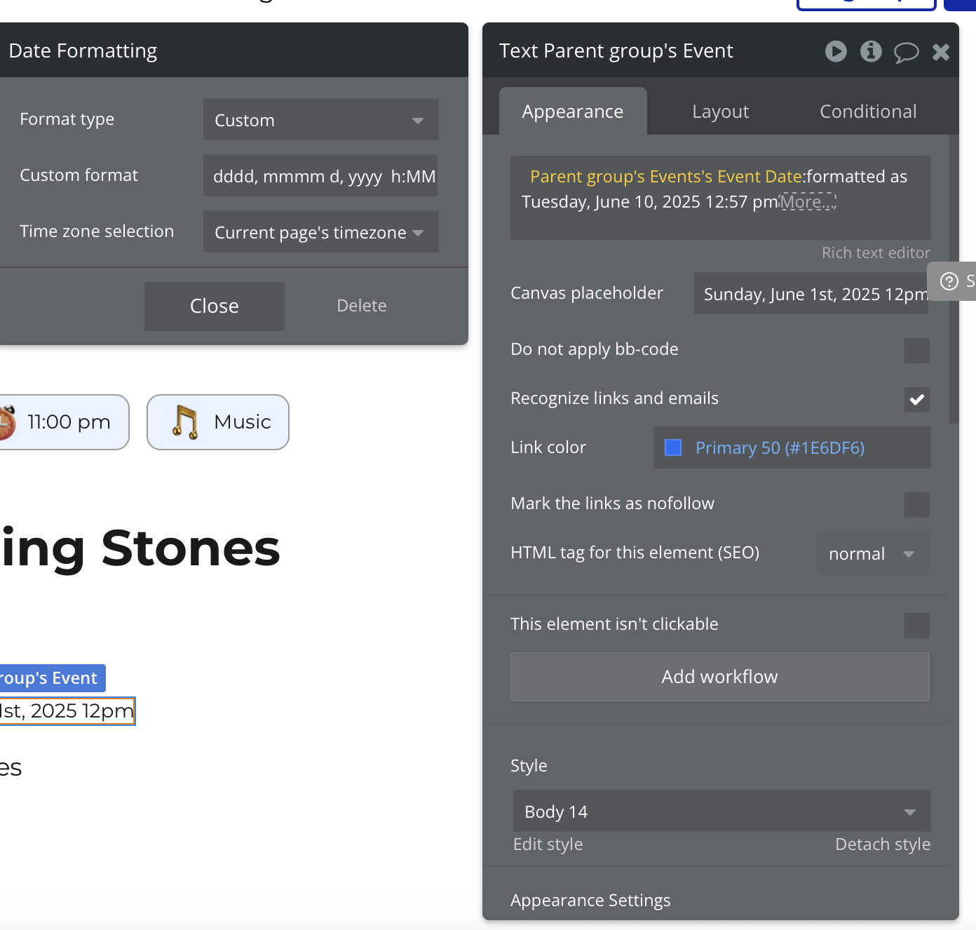

You can use custom format (last option I think in the dropdown). You will be able to set all you want. But if you don’t use formatted as, by default it will display date and time. But you will need to live with Bubble default formatting.
Should be quite easy using the custom format:
The full formatting in my case is
dddd, mmmm d, yyyy h:MM tt
Which displays my date as “Friday, June 20, 2025 12:00 pm”
