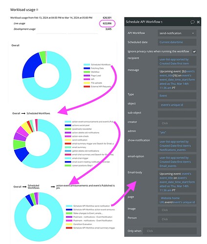

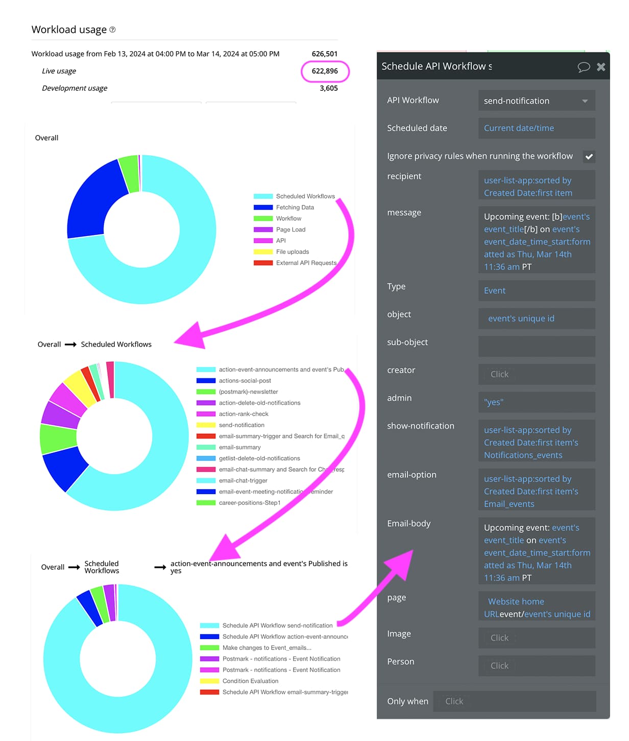

I’ve attached two images to show you the usage breakdown, and the workflows. I would love help to figure out why this workflow is using so much workload units.
Can anyone tell me why this is costing so much? I’m always over 600k each month, and this is the main reason I’ve not switched to the new pricing plans as it will cost me a fortune.
I can’t figure out why this is costing so much when there are other processes I would have thought would be more intensive. This is simply creating a data entry for my notification system. Yes it might be sending to my full list of users(1,000), but the other processes like sending to PostApp to send an email also do this.
Is there anything I can do to optimize this?

My theory is you’re sending that user list as a param, bubble charges like 0.02 to pull 1 record. When sending lists the entire list is loaded when it’s sent. I’m assuming you’re looping it so every time so it’ll cost roughly 20 Wu the first loop, 19.98 the second to pull 999 users, etc etc

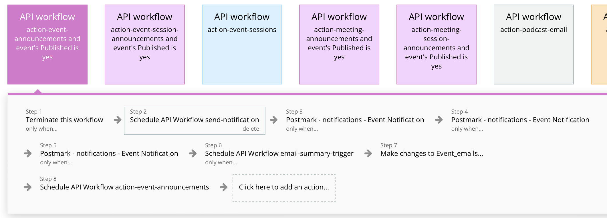

When an announcement is triggered I run it through several workflows to determine the final list. Some events have restrictions based on things like if it’s member only, location specific, if they already registered for the event, etc. Once I have that final list it gets sent the the attached workflow.
It runs throught these steps in a loop for each item until the list is empty. Step one terminating if the list is empty, and the last step looping removing the person it already ran the workflow steps on.
Both the notifications and emails are being sent to 1 person at a time using the same process of taking the list, sorting, and taking the first item. I’m thinking maybe I could optimize it by having the second step just finding the user, and then all subsequent steps can just use results of Step 2. That would remove all the sorting each time. Anything else you think might help?

Once a list is created are you not just passing that list? I know when I worked with one of the Bubble people they mentioned I don’t need to sort the list multiple times, because once the list is sorted and you pass it it does not change, so you don’t need to keep sorting it. Why does it cost a lot to pass a static list?
Also, if it was the list passing would the one showing the high usage be the one actually passing the list(The last step)? This is actually just the one sending to the Send-notification Workflow. On the middle pie chart(yellow) that workflow does not seem to be costing much, but just the one that’s sending to that workflow.
