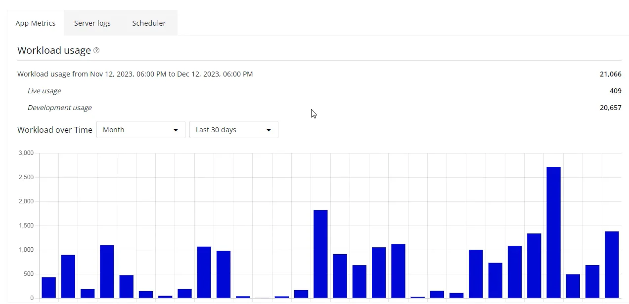

In short, the sum total of our WU pie chart does not add up to the reported total WU for our environment. The pie chart under-counts by more than 50%. Here’s a video below showing this as well as how drilling into a pie-chart wedge results in a similar discrepancy where the sum total of the drill-down pie chart does not equal the size of the wedge we started from.
Anyone else seeing this? If so, please share your discrepancy numbers if possible - thank you!

Hi @zelus_pudding - Thanks for sharing what you’re seeing. We have seen a few reports of this come in where the top metric above the bar graph is correct and accurately represents the total workload units, but the drill down is not correct and is missing workload units. Specifically:
  • We’ve seen a few cases where the pie chart does not add up to the total displayed above as noted in the video
  • We’ve also seen cases where the drill down does not work — so clicking on something like Fetching Data — will refresh the chart as if it’s going to drill down, but not actually display the data.
In both cases, the top level metric is correct but the pie chart is not. Our team is working on getting a fix together for this, as we know not having accurate metrics when drilling down into workload unit consumption can make it challenging to optimize your app and address any new issues that might need investigating. If you have specific questions about your app and workload units, please reach out to our team and we can take a look. I’ll follow up here when a fix is in place.

Hi all - Apologies for the tardy update here! We pushed out a fix for this on December 20 and then were monitoring things over the holiday season and I neglected to update this thread. Pie charts post December 20 are displaying data correctly and they should match what you see in the bar chart at the top of your logs page. Unfortunately our fix did not retroactively update charts from before December 20, so if things are incomplete when analyzing longer periods of time, that’s why - as a result I recommend looking at the last week or so of data when trying to analyze trends if you’re diving in to workload unit analysis! As always, please reach out to our team (our new chatbot is pretty incredible) if you see anything that you need us to further investigate.
