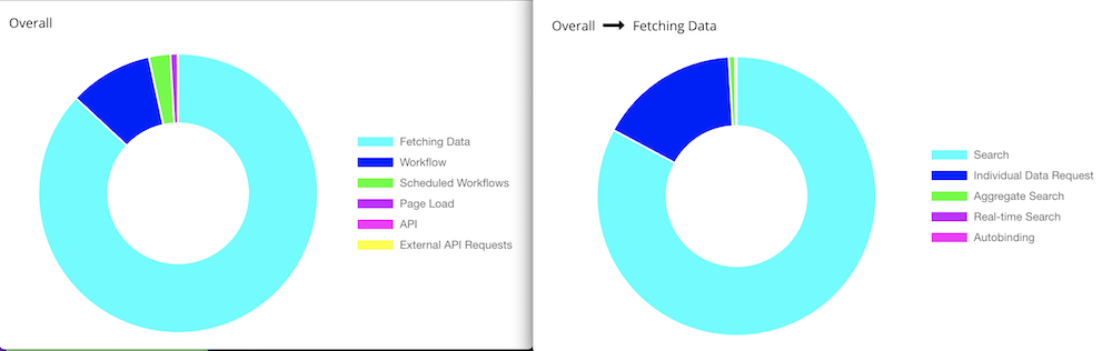

I have been monitoring WU usage like a hawk, and thankfully things are currently manageable - but I can see that searching is what is wracking up the units. As it’s a marketplace there is no guarantee of sales, and a user can browse and search for ages without buying anything. The thought of 1 million users doing this at the current WU costs is pretty scary. Therefore I am doing everything possible to get the search cost down.
Currently the search is performed on the page load (once logged in) and it pulls in 18 products per page. Each record has a weight of around 30kb. I can likely get this lower using a satellite method as not all fields are relevant to the initial search, so that is going to be my next step.

Currently we have 2000 users and it’s using 250,000 WU per month. 90% of this is on the searches. So that is roughly 125 WU per user per month. When we add the additional search areas, this will likely increase further so I picked 250 WU per user (per month) as an estimate.
250 WU per user per month x 500,000 users = 125 MILLION WU units required., per month. [250 Million required when we reach 1 million users].
