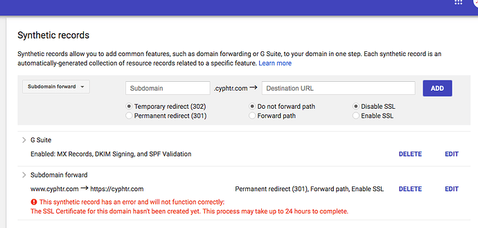

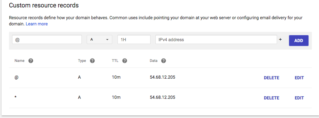

Hey there. I have google domain “naked” right now (without the www). Is there a way to have both? Before bubble I was using the domain on a www squarespace landing page and generated some SEO, so now that Im via bubble and not squarespace- its just https://cyphtr.com . However, everything keeps redirecting to www.cyphtr.com and returns an error code
Here’s my DNS settings
Here’s my bubble settings which I just tried to mess with and thats why its showing an error message, so just ignore that.

I would try setting your TTL value to 600 seconds, and make sure this box is checked in your bubble app settings.

If you still want the function of the ‘www’ then use forwarding. Synthetic records:
www → https://cyphtr.com (Destination URL) and set it to Permanent redirect (301))

Create another A record. Replace @ with *. Everything else stays the same. This generally is the simplest method and serves as a catch all.
Thank you so much!
I tried it and, still returns the same error message when I try using www.cyphtr.com though.

Ok so I tried as you suggested but I wasn’t sure if “Enable” or “Disable” SSL. I went with enable.
Thus this is what it returned and I still get an error when I try to enter www.cyphtr.com

If you have the Enable SSL on the bubble side, I would try disabling the SSL forward on the google side.
If this doesn’t work, I would make the Destination URL just cyphtr.com within google. Because navigating to cyphtr.com already redirects to the https version. I’d still disable Enable SSL on the forwarding either way.
It may take a bit to propagate though.
Ok so no red flags this time from google trying it “disabled”.
I did have to delete the previous attempt bc “it conflicted with the previous record that might take 24 hours”
So I deleted, tried again with the disabled clicked and voila, no red flags like I mentioned. WWW version of my site still sends me an error code, but I think it just needs time like you mentioned. Ill post the verdict regardless incase anyone in the future finds this useful.
