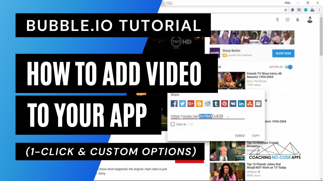

@ramnoodles Welcome to the community!
Thank you ! I already have added ziggeo video and it is working. However, I can’t get the screen recording feature to work. Are you able to get screen record feature to work?

The Bubble team built plugin that is available as in the video above shared by cmarchan does not have all the options that other plugins provide. To my knowledge the screen recording is also not available for it.
