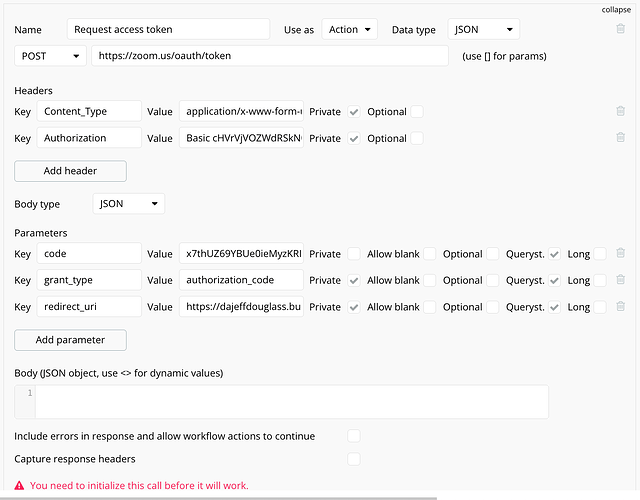

I have a problem when I try to get an access token on my Zoom API call. It shows this message “reason”:“unsupported grant type”,“error”:“unsupported_grant_type”.
And it’s a weird situation because when I test this API on Postman it works perfectly.

Hello, I take a look at it, I found the code expires again it this time, and when I login through Zoom to get a new code, it say the app is not found, ( probably i don’t have the correct zoom package)
But I found the code in Vidro when I pause it at 1:52 starting with x7thUZ69Y … In you call is NhBar7E93 so maybe you mistype the code.
To get the correct code, as we are on a free plan, I put a when page load workflow and look for code with only with code is not empty in URL, and save it inside the user code field.
Secondly are you encoding your ClientID + : + Client Secret … Because when i decoded your Authorization key it is not the same as ClientID + : + Client Secret
when you look in the documentation of Access Token, your request header Authorization description you find you need to encode it into base64 like this ClientID + : + Client Secret
Other than this it looks fine, kindly log in again and see if the code is being saved in the database, if so use it and also encode your ClientID + : + Client Secret and give it with Basic in Authorization header.

Thank you so much again. Yes, you are right. This code changes all the time, so it was a smart idea to save it for the current user. But unfortunately, the code is not saved when the page is loaded. I can’t understand why.
Before I was using the development encoding ClientID:Client Secret, but are you saying that I should use the production encoding ClientID:Client Secret? I just changed it to the production encoding ClientID:Client Secret and it still not working. Could you please send me or insert this code directly on the Bubble editor? You can get the ClientID and Client Secret directly from the OAuth2 call.
And the same error still happening.

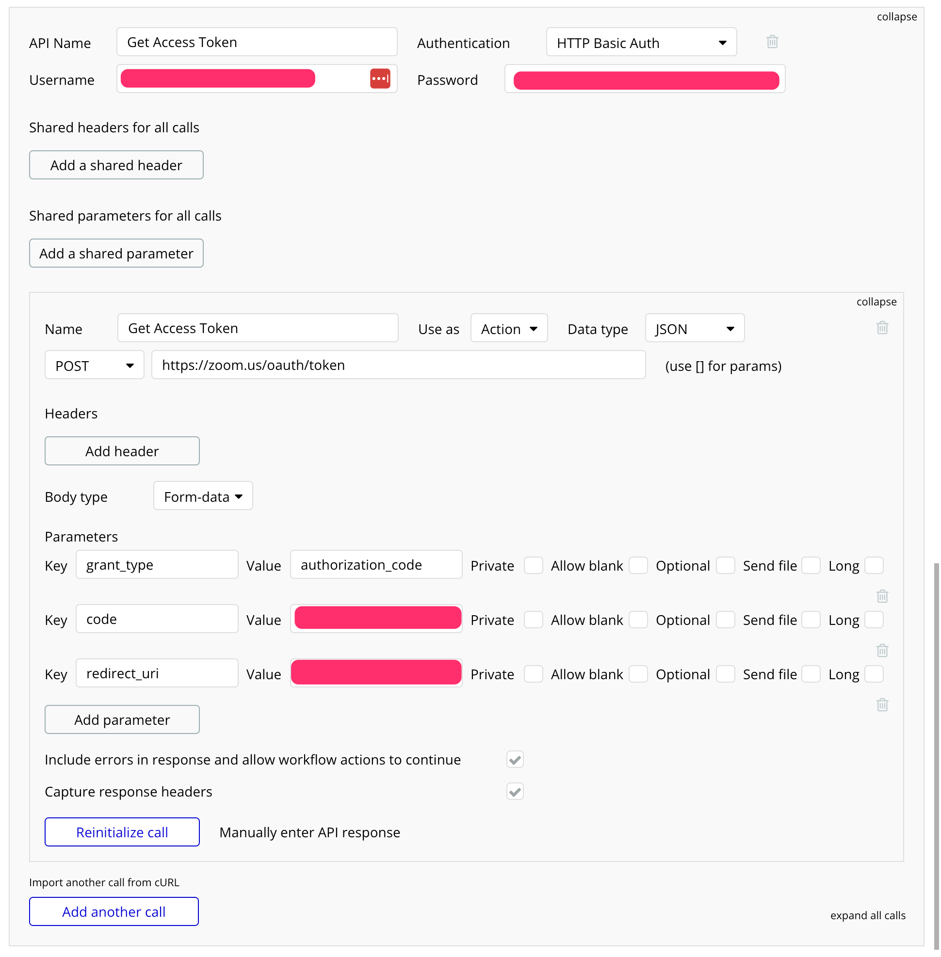

not sure other people like me, i move API NAME:Get Access Token to Authentication:HTTP Basic Auth and add username & Password then i get Token.
