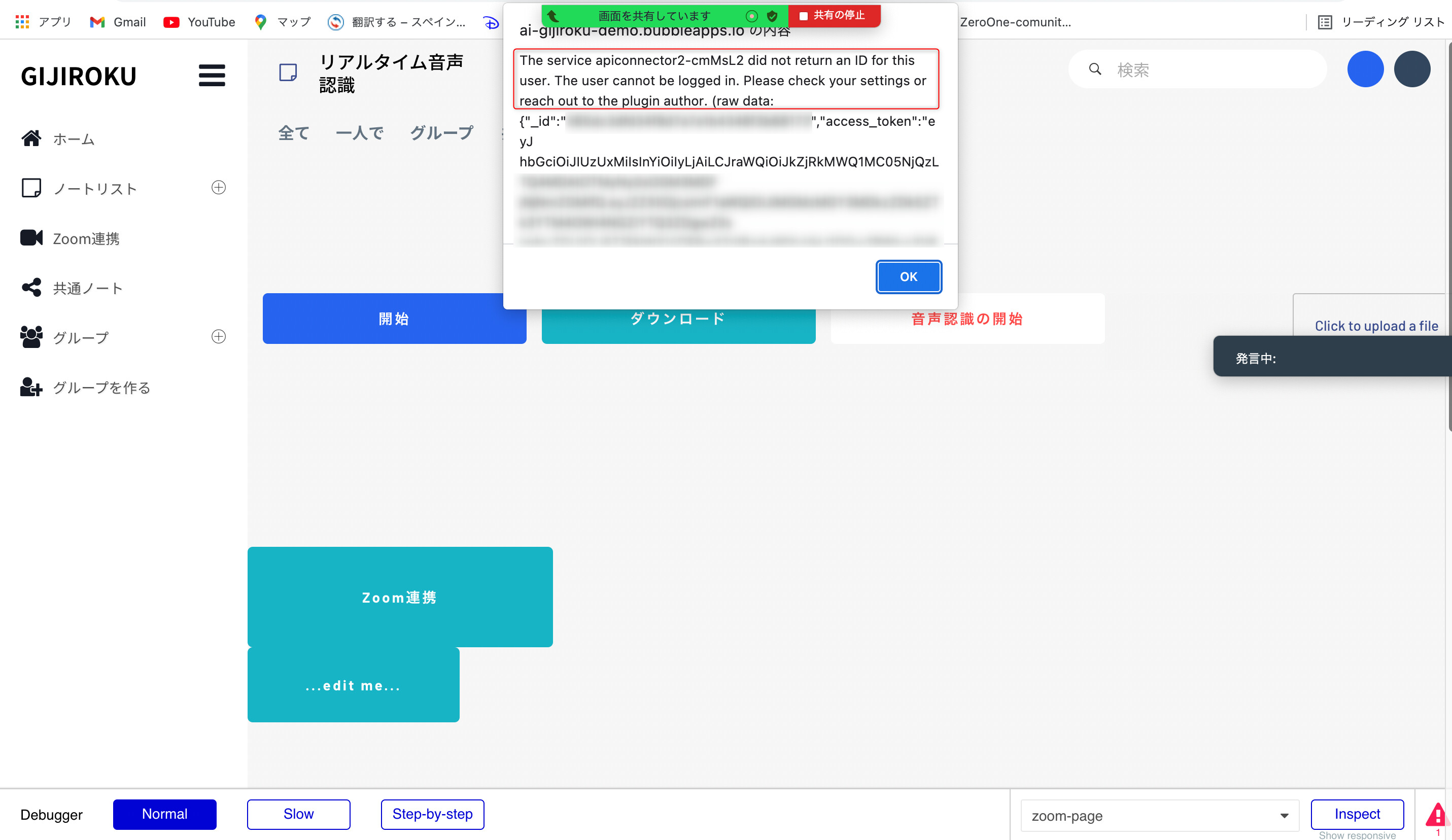

Hello there, I would like to ask you how to retrieve user data from ZoomAPI to Bubble.io app.
I am trying to connect my bubble app to Zoom with OAuth2, however it keeps emitting some errors.
Firstly, the bubble API plugin says that I have to authorise this API. The bubble app guides me to Zoom login form, but after that, I get this error which says that “This service did not return an ID for this user. The user cannot be logged in.”
I checked all details but it doesn’t look wrong for me. Then I wondered if the redirect properly goes through, so I tried to access the redirect address with a code which was generated by Zoom as a parameter, then I got an error code 400.
{“statusCode”:400,“body”:{“status”:“ERROR”,“message”:“Missing state from oauth provider”}}
I have no idea how to solve this issue.
Please help me the way to use API to retrieve user data. Thank you so much.
For the error highlighted in the red box. - Create a workflow with the action “Sign in with OAuth” and then select “Zoom” from the list of OAuth provide. Then try to log in with zoom.
Thank you for replying.
I tried that behavior but it returns the following error.
@jidoca.engineer
Need to experiment with a couple of things.
  1. Remove the “/” from the user profile endpoint URL.
  2. Can you uncheck “Authorization goes in the header”
Can you check now?
